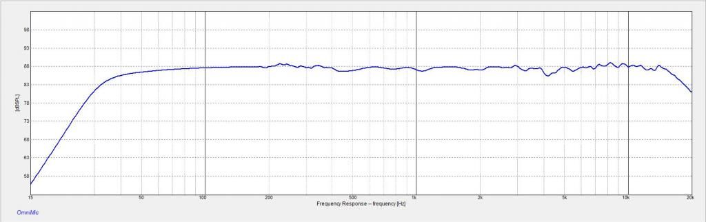

Following from Jeff Bagby in the above linked thread:
Here's a response curve that they didn't show. It's a measured frequency response on the tweeter axis calibrated to 2.83V at 1 Meter with the summed Nearfield bass response spliced at 150 Hz for what would be a full-range Quasi-anechoic frequency response. I used 1/48th oct smoothing and an 8 mSec gate.
I thought using smoothing tighter than 1/12th octave gave a chart that was difficult to read. Is that BS?
Kind of wish the top end went higher. I know my ears probably don't hear above where these start to roll-off, but I also know their is something about ribbon and Be tweeters that I like (call it a "shine", if you will) and if it isn't high frequency extension, I don't know what it might be.

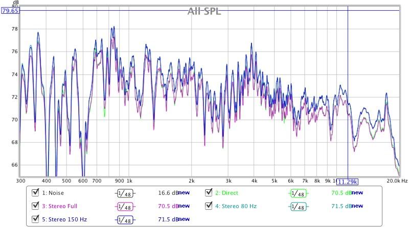

It's not it makes it more difficult to read, but the more smoothing that is applied tends to yield a graph that might give an inaccurate picture of what the speaker is actually doing. IE a medium hump suddenly could become just a minor bump and vice versa with dips/suckouts. 1/12ish is supposed to give the best balance between making it relatively easy to read while not artificially glossing over anything, at least to the best of my knowledge.

[QUOTE="fuzz092888, post: 1065595, member: 59310]It's not it makes it more difficult to read, but the more smoothing that is applied tends to yield a graph that might give an inaccurate picture of what the speaker is actually doing. IE a medium hump suddenly could become just a minor bump and vice versa with dips/suckouts. 1/12ish is supposed to give the best balance between making it relatively easy to read while not artificially glossing over anything, at least to the best of my knowledge.[/QUOTE]
I understand the theory, but this graph at 1/48 is easy to read. Is this speaker somehow unique?

[QUOTE="fuzz092888, post: 1065595, member: 59310]It's not it makes it more difficult to read, but the more smoothing that is applied tends to yield a graph that might give an inaccurate picture of what the speaker is actually doing. IE a medium hump suddenly could become just a minor bump and vice versa with dips/suckouts. 1/12ish is supposed to give the best balance between making it relatively easy to read while not artificially glossing over anything, at least to the best of my knowledge. I understand the theory, but this graph at 1/48 is easy to read. Is this speaker somehow unique?
That doesn't look like 1/48th I think it might be a typo and its supposed to read 1/8th.
This is what 1/48th looks like
