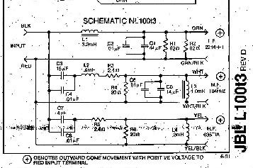

I haven't heard those, so I can only make general comments. Were the L100t3s made in the late 1980s? Compared to their namesake, the L100 from the 1970s (which I own & modified), there are some obvious changes. It might have been an improvement over the 70s version, but that's only a guess.
  • All three t3 drivers are different from the L100. The woofers look like they have foam surrounds. Are they in good condition?
  • The cabinet is much larger. The older version's cabinet was too small for it's woofer, causing an exaggerated bass peak in the 70-100 Hz range.
  • Unlike the L100, the t3 actually has a real crossover network (see schematic below), with frequencies of 800 Hz (woofer-mid) and 4.5 kHz (mid-tweeter). Is it a good design? I don't know, but I'm certain it's better than what was in the L100s from the 70s.

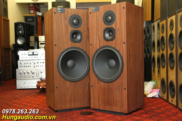

The speakers came in with surround dry rot. I had the foam replaced on the company's behalf for $144.06 and got the woofers back about a week ago. I installed them and have them connected to a little Denon Midi receiver that I brought from home (Denon D-60). The receiver probably only musters up 15-20 watts per channel if it's lucky. Usually just listen to radio, but they sound impressive with the radio and I had the thought to play Tchaikovsky 1812 Overture through it with my phone and those cannon blasts were awesome. The speakers are reasonably efficient at 91dB so the puny receiver was able to take them to levels of output that were respectable. We have hard concrete floors and the speakers are behind a display case.
This picture shows how close to the wall they are and they are rear ported. I don't have many options as far as placement goes because I do not want customers removing the grills, poking the speakers, and doing otherwise misplaced things.
Obviously they are quite large so it shouldn't surprise me how dynamic they are, but they do. If they sound this good in the store I can only imagine how they would sound at home. The only thing I can't get a feel for in the store is how well they would create a stereo image, how linear they are, listener fatigue potential, etc...

Those 2nd order electronic filters I see in the schematic, could combine with the inherent roll-offs of the drivers (if this speaker was properly designed). This might allow the acoustic behavior of the crossovers to be more like 4th order. You are mainly hearing that 12" woofer crossed at 800 Hz to a 4" mid range which goes up to 4.5 kHz. That has the possibility of good imaging.
What I'm trying to say is that nothing I see in the general design would prevent these speakers from sounding good. Take them home and try them. I bet they're heavy.

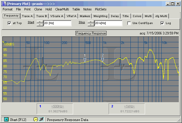

I'm sure that these (in their original configuration) can sound good in some rooms, with some music, but with music that was mixed on better speakers and played back with better speakers, the sound of the mix is glaringly apparent. I heard a Don Henley song last night and it was pretty weak, but it used to sound good when it came out and was played on the radio. Probably had a lot to do with their processing for broadcast and the local station that would have played it processes the crap out of the sound. When I heard these at the customer's house, they were OK, but to be honest, JBL sound was never my favorite- peaky mids and highs never did it, for me. I'll have to see if the owner of the ones I checked out would be interested in doing the upgrade.

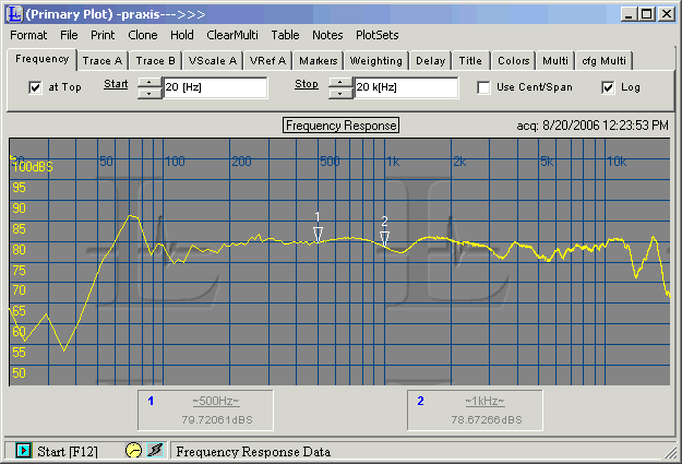

I found the new crossovers made for much improved sound, regardless of the music. And I had been listening to them for over 30 years. So I was completely accustomed to their "old" sound.
The large peak, between 6 and 7 kHz (see below) was made by the mid range driver, which had no low-pass filter at all, and had a 1st order high-pass set at 1.5 kHz. As a result, any sound at roughly 800 Hz or higher could generate some ugly sounds, if the harmonics stimulated it in 6-7 kHz range.
The new crossover eliminated that
