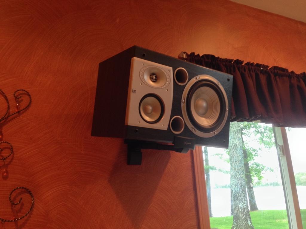

FWIW you can also hang any bookshelf on the wall. Like the HDI’s for example.

Those k&m look pretty nice.
I used these Vogel’s vlb 200 for a long time. They held my side surrounds which weighed around 35lbs each.
Those are still bad ass speakers that can put forth an incredible sound image I still use Two as front presence channels in my system .
