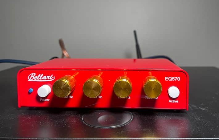

JBL L110. Boost 2 lower bands a little and decrease higher bands a little. My tone controls never worked on my amp for some reason so I bought an EQ.
Bellari EQ. Very nice.
So tweaks the basic power spec....if you're using eq then a more powerful amp is likely in order....
Using an equalizer can cause its own problems if the level controls are raised, rather than using a balance of raising and lowering- the needed amplifier power can be adequate without the EQ, but these are used too often as a way to achieve more output when it's supposed to be used to balance the frequency response.
I would advise against using an equalizer to raise the level- if the level is too high, it can cause distortion.
