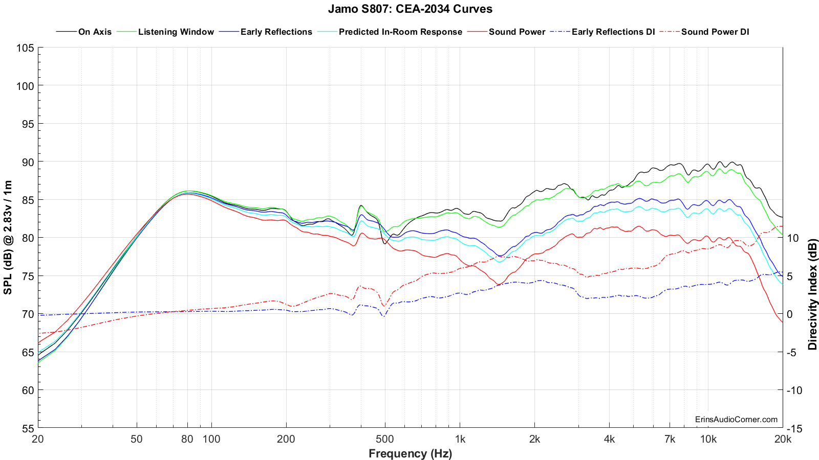

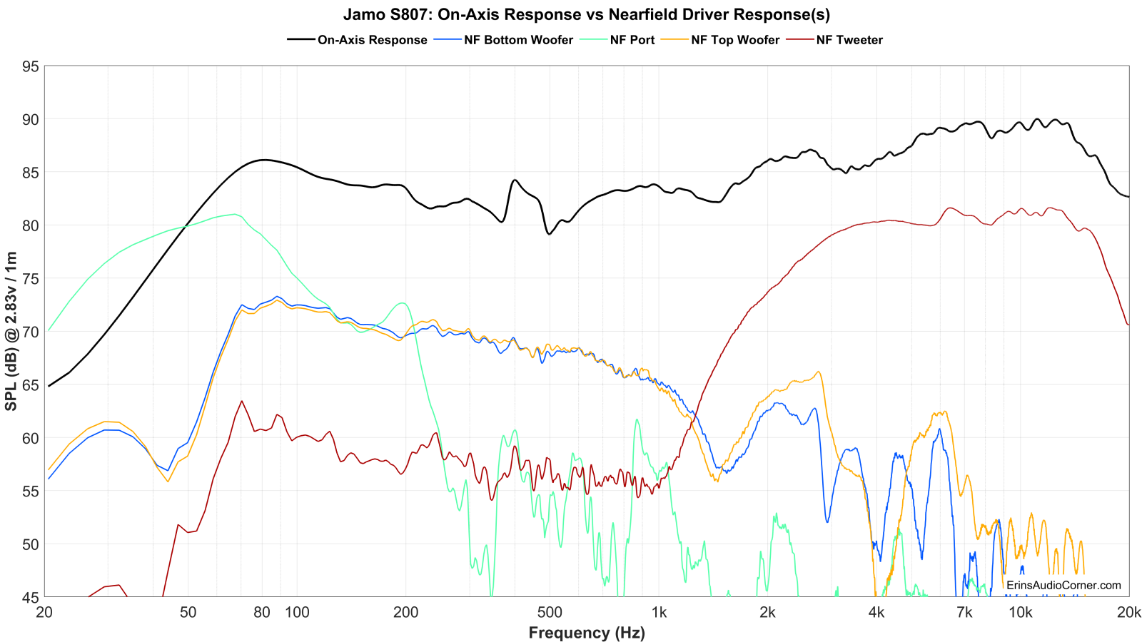

I ordered this speaker last week in hopes that it would be a diamond in the rough and that if it were, people might be interested enough to buy it through my Amazon affiliate link and I could use that money to get some real cool speakers to test. Well, that isn't gonna happen. You can read my review in the link below:
https://www.erinsaudiocorner.com/loudspeakers/jamo_s807/
Some highlights (or lowlights, really):

Oof. Talk about lipstick on a pig! I like the wood grain accent of the base and the Wave Guide. Too bad that's where the beauty ends.
BTW, I like your inclusion of the ±1.5dB and ±3dB windows on the FR!

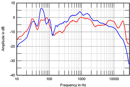

Wilson Audio Sasha FR graph-
I guess people like them, even with this.

Another amazingly comprehensive review, very nice! The response reminds me of the Dayton MK402. That could be greatly alleviated with a typical treble tone control knob with knocks down output above 3kHz. Maybe these could be made to sound a lot better with a simple tone control knob change. I liked the Mk402 overall but one reason for that was that it was $60/pair when not on sale, and the fix for them was easy. The problem with this Jamo speaker is that even if you tamed the highs, there is still that bass boost. It is just too aggressive for the shape of that curve.
I would be interested in seeing measurements for the Jamo C98 II that Andrew Robinson has very high praise for in this review.
Again, outstanding review, and I am looking forward to seeing more of your efforts!

Any crossover modification would not improve this speaker's high frequency performance. The purpose of a XO is to divide frequencies between drivers but it cannot correct a driver which fails to have an almost linear frequency response. IMO, it's just a poor design.
When I build speakers, I always look for drivers which can match to each other while having been shown as having a relatively linear frequency response when tested on their own. That's why, when you know how speaker drivers are built and work, you can build speaker systems that can have a better performance than commercial speakers costing many times the monies that you put with the DIY route.
