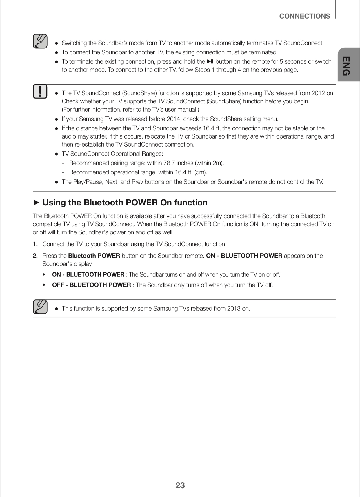

New question….
My other tv is a UN55MU8000F with a HW-KM45C. Both Samsung. The issues with the “TV ARC” connection is worse on this combo so but unlike with my 65” QLED and soundbar we were talking about before, it seems as though the only way to control the soundbar with the tv remote is to have the ARC connection active with the HDMI cable and when I use the optical cable, there is no control over the soundbar from the tv remote. Is there a way to change that or am I forced to use the TV ARC or the TV connect which is basically the Samsung to Samsung Bluetooth connection? That way works, but only for the volume control.
Trebdp83
Full functionality of TV SoundConnect may not be available with some TVs. See if this helps at all.
