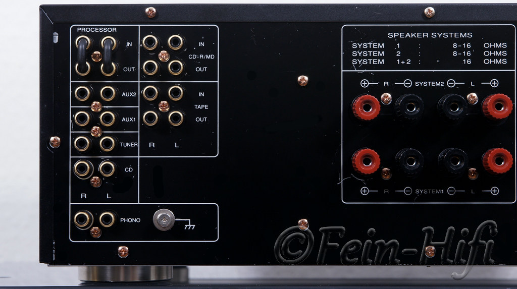

I just bought a used Marantz PM 7200 with Studio Monitor 55 speakers. I have connected the speakers to speaker 1 outputs. The amp is powering on and I am able to select the inputs as well. I am not getting any signal on the speakers. How do I check if the amp is functioning. I don't have a CD input to test. I was trying to test with the Aux1/2 using my ipod.

There are a lot of possibilities with that one. Make sure the "main in" (may say processor) connection is connected. Should be a little jumper on the top left of the rear. No jumper = no sound. On the front, set to one of the AUX inputs and ALSO select speaker A or B depending on output you've selected. I had a PM7000 and 7200. Nice integrated amps.

The processor in out jumpers are in place and I have connected the the speakers to system 1 and have selected the speaker A switch in the front panel. I am using a AV cable to connect my ipod on Aux 1. When I power the amp I get a click sound as if a relay is energised and then I don't even hear a hum on the speakers. I will arrange for a proper cd player with Av out and check again. Any other possibilities.
I have kept the source knob at off position and have not selected class A and source direct options.

It seems you are doing everything right. You should at least hear a faint hiss from the speakers with an ear right over the tweeter.
I have a strong suspicion this amp does not work, and you have been sold a dud.
Get a reliable input source. Make sure you see if you can hear from the headphone jack also.

I would try and connect RCA cable in on the CD input, same channel you have the speaker, set it on low and tap the center pin on the end of that cable see if you get a buzz.
