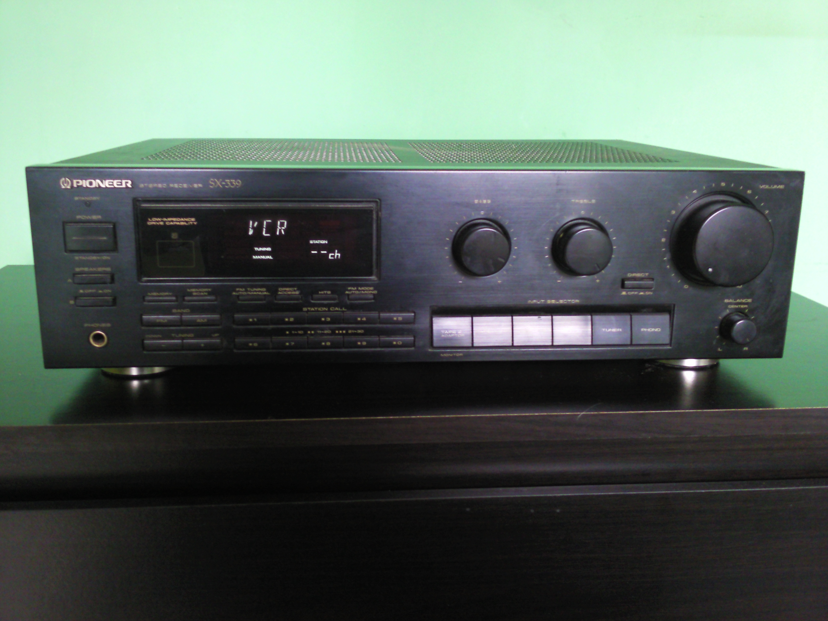

This is the unit we are talking about, correct?
The unit is a 55 watt per channel, and will drive loads as low as 2 ohm. So it is more robust than most modern consumer grade units.
