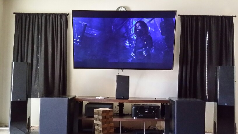

Oh man... I just came really close to trying a stereo bass setup...
