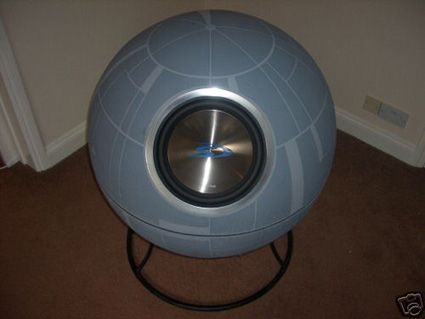

While we're on this topic:
The Force is with you, young John, but you are not a Jedi yet.
:D
