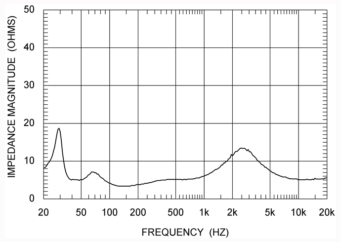

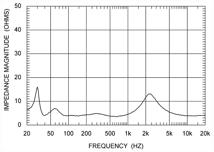

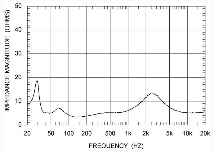

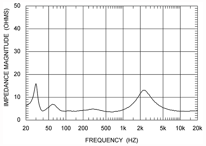

If your listening environment and habits remain the same you should be find with the X4400H. The R11 is definitively considered 4 Ohms nominal, same as the R500. It's sensitivity is about 2 dB higher so it may actually be a touch easier to drive. I think they will sound very similar to the R500 in a small to small medium size room.
In either case, it really depends on your power need (distance, desired SPL?). If you sit far enough and listen to high enough SPL then you need an external power amp, no AVRs can help much regardless of price. For power amp, you should go for something rated at least 3 dB more output than your X4400H, such as the Parasound A21+, Anthem MCA 225, AT52, March Audio P502.
SoundStageNetwork.com | SoundStage.com - NRC Measurements: KEF R11 Loudspeakers
SoundStageNetwork.com | SoundStage.com - SoundStageNetwork.com | SoundStage.com
R11:
R500:
R11:
R500:
