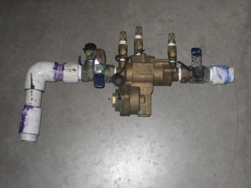

The day before I had to go out of town, we had a irrigation line break. I tried to do a quick fix but afterwards the funny manifold looking thing sprung a leak. Since I was in a hurry, I just cut it out and spliced a straight piece of PVC in place.
In my city, this thing has to be 15" above the ground but I thought it only was for the sprinkler system. Now when we flush the toilet or run the shower, the pipes in wall wall rattle like there is air in the lines. I think maybe this manifold thing is supposed to be in place.
Thoughts?

That looks like some type of pressure regulator valve, not a manifold. It seems there is an entry and an exit, and it is not a distribution device.
Have you noticed a change in water pressure? If you have I would replace it pretty soon!
It looks like the leaks were on the valves (going by the mineral stains). If that's the case, just replace those but install a bronze union at each end to make servicing it easier, if and when the time comes again. Otherwise, replace the regulator and still use a union at the ends so you don't have to cut the lines to service it.

Greg, the pipe noise you hear is water hammer, due to the new high pressure.
So, when shutting off faucets, do it slowly to avoid that banging noise.
Water hammer can cause pipes to break in the wall.
As TLS suggested, I'd get this put back in place.
I would call a professional, for many reasons.
The first being, you have to used a primer and a glue that specifically formulated for that type PVC.
It looks like you cut the pipe too close to the connector and coupling, so it won't be just simply gluing a coupling in place.

This is what I would guess. If the pipes are rattling then there is some sort of air lock in them, which is actually caused by not enough air getting into the system. Are your drains draining slowly?
ParadigmDawg
ParadigmDawg
Drains are normal. Water pressure seems the same but the rattle for sure started after I removed the back flow regulator.
I have been busy with the grandchildren this weekend. However now I understand your system after getting a few moments to myself.
What you have is a Febco 860 reduced pressure double check back valve. This is the 1". It also comes in a 1 1/2".
Now these type of systems are mandatory by law, so you and your family do not get sick from soil organisms.
The function of these devices is three fold.
It stops your house water pipes draining back into the irrigation system. That is why you have the noise in your pipes, as they are filling with air.
The next and most important function is to stop your house water system becoming contaminated with dangerous soil organisms.
The third function is to regulate the pressure in your irrigation system.
Here is an article that explains all this.
Here is more details on your system.
Immediately, I would cap the end of the pipe that goes to your house.
Have a plumber fix this problem.
You will need to take expert advice in how to sanitize your house plumbing. In the meantime BOIL ALL DRINKING WATER.
Have you had any freezing? If you have this may be the cause of your problem. These valves have to be drained for temps below 32 F.
