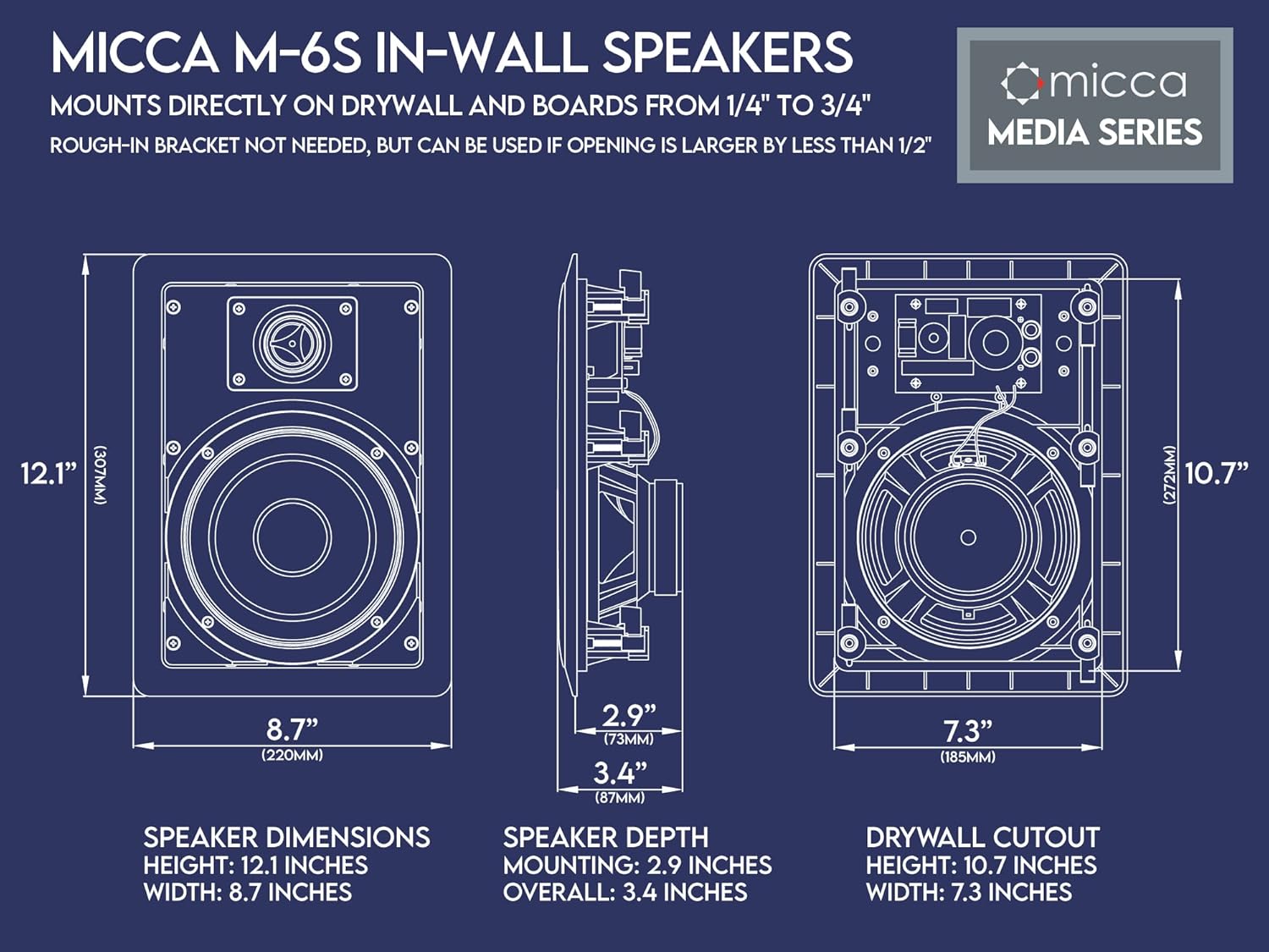

Hi, we moved into a new home. The home is wired for 5.1 surround system. However, when I looked to install in wall speakers, I noticed the box (provided by the builder) is next to a stud (I believe). Picture is attached. A question I have is, to install the in-wall speaker, should I cut the drywall away from stud so that the speaker can hold on to the wall from all 4 sides? If so, I believe I need to patch the existing hole (as it is right next to the stud). Please advise.
this is the speaker I intend to install in the wall:
Micca M-6S 6.5 Inch 2-Way in-Wall Speaker for Home Theater, Whole House Audio, Indoor or Covered Outdoor Areas, 6.5" Poly Woofer, 1" Pivoting Silk Tweeter, White, Paintable, Each https://a.co/d/f9wEAG2

That will depend on the mounting system. Those speakers have tabs that rotate in behind the drywall and the drywall gets clamped between the tab and the speaker frame. The tabs rotate clockwise, so the bottom right tab will rotate to the right side, but the bottom left tab will rotate downward, which will hit the stud if it is located below the box as you have indicated.
I can think of two options, assuming that the box will be removed. One is to patch the hole and move the speaker higher to allow room for the lower left tab to rotate downward (be sure that the tab is not behind the patch but behind solid drywall). The other option is cut the speaker opening right above the stud. That should leave a large enough opening that you could use a wood chisel to chisel away part of the stud and leave a space where the lower left tab would rotate into.
