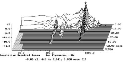

Judging from the measurements at Stereophile, I would say YES. Below is a measurement from an accelerometer on the cabinet with the description from Stereophile. This information and image are (obviously) Copryright of Stereophile.
Fig.8 Paradigm Reference Studio/20, cumulative spectral-decay plot of accelerometer output fastened to cabinet side. (MLS driving voltage to speaker, 7.55V; measurement bandwidth, 2kHz.)

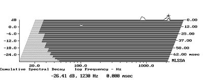

You want as little resonances as possible. For reference, here is the same measurement done on a Rockport Antares:

This is a bit over my head, how do the resonances and decay manifest itself when present? Lack of clarity perhaps?

The effect is perceived as a distortion of timbre. The phenomenon of resonances and perception, as well as audible thresholds was researched by Dr. Floyd Toole and published [1] in JAES for peer review in the late 80's.
-Chris
[1]"The Modification of Timbre by Resonances: Perception and Measurement", Floyd Toole, Sean Olive, JAES, Vol. 36, No. 3, 1988, March, pages 122-141
