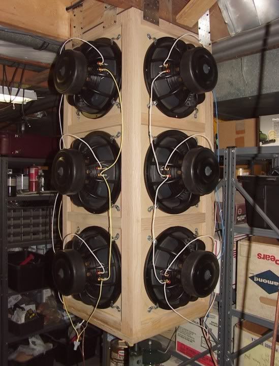

IB is definitely the way to go if you're not afraid to cut out a hole in the floor or ceiling. It will take a bit of rough carpentry or drywall work/framing to do it, but it's worth it. You'll also want a solid pro amp and BFD. Here's some of my favorite pics of IB's. Imagine 12 - 15" or 4 - 18" drivers pumping bass throughout your house.
mtrycrafts
mtrycrafts
Nice. As one can see, not too terribly complicated, just need space and understanding neighbors:D
