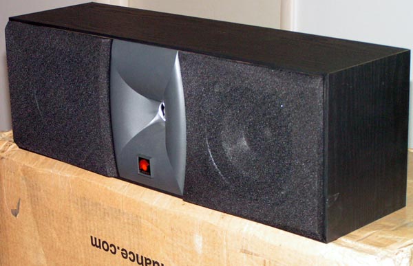

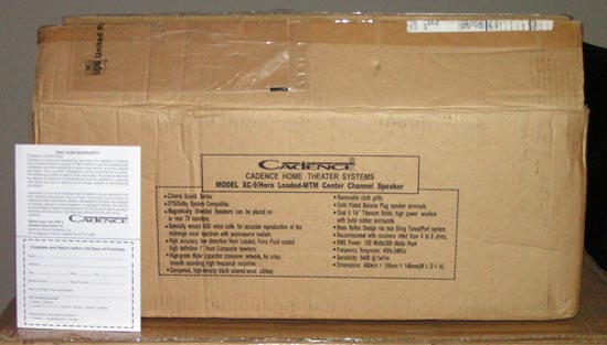

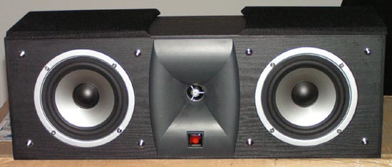

Hey Frogman... I totally forgot. I have a center that may be right up your alley for sale. Seriously I totally forgot about it.
I know its quite sensitive at 94db, and if I recall the FR is 55hz to 20Khz it has dual 6" and a 6" horn... And is in your price range by far. Its the Cadence XC-9. Here look here, then if you want the total specs I will take a pic of the original box with all the specs. I keep my equipment in 110% condition, and that speaker has about only at max about 15 hours on it.....
Look at this thread...
http://forums.audioholics.com/forums/showthread.php?t=13066
If your interested then PM me, and I will give my # and email address...
This might be exactly what you are looking for. Sorry, I totally forgot it...
I have just so much equipment, and forgot about that one....
EDIT:: Here are 3 pics, I can send full size pics to your email....
By chance I had a few pics still in my computer... So I uploaded them:)

That's a deal Frogger. It's not as nice as the DV-62, but I can guarantee that it's much better than what you have right now and the price is right. Since you're trying to be as cost conscious as possible, I think that you should take up Brian's offer. I've bought some stuff off of him (as well as other members here) and I've never had a bad experience. There's a good group of guys that hang here (and maybe a couple laides ;) ).

Sounds like a winner to me. Just a note. With an upgraded center dialog will become(or should) crystal clear, but for music, you will probably have to trim it a few dbs.
Brian's a great guy, take him up on it.
