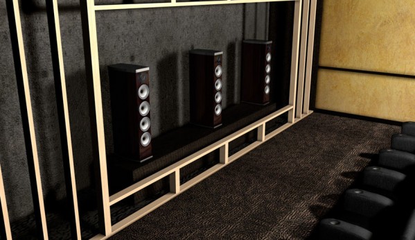

Last, you can go full Monte and set up speakers behind a wall with an acoustically transparent projector screen:
