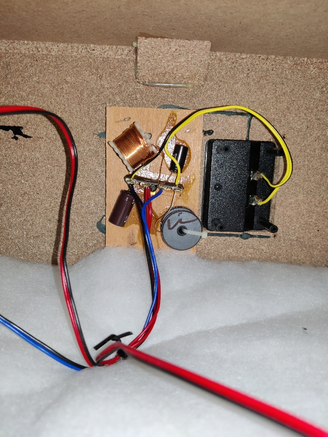

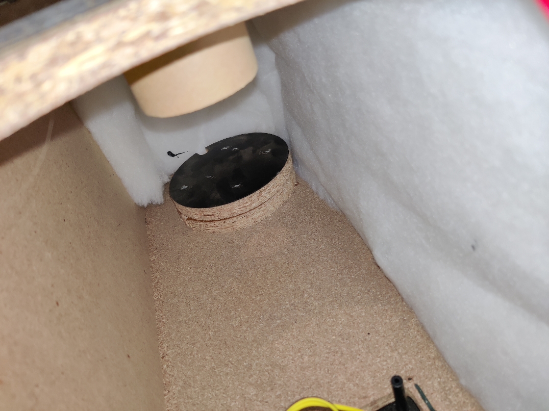

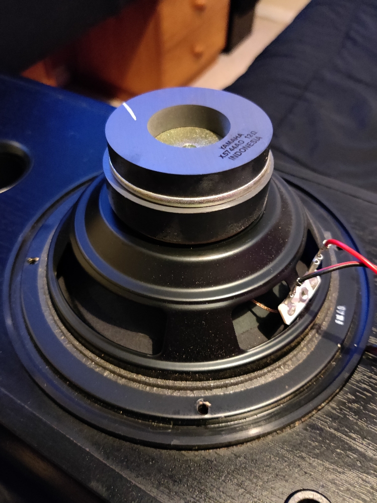

So I have Yamaha NS-50F front speakers , relatively inexpensive speakers that actually sound quite good to my ears
. Now I can't afford to upgrade them right now and if I do , anything that will be substantially better is fairy expensive here in NZ ie svs prime towers are $2499 a pair here . The various Polk's or Klipsch are around$1200 a pair but I'm sceptical they'll outperform the Yamahas enough to warrant the upgrade. So I'm looking at possibly improving what I have . Heres pics of the interior of the Yamahas. There's no cross bracing and only dampening material on one side strangely. As a side note the extra magnet attached to the rear of the motor is strange to me . Opinions ? A fools endeavour??

So I have Yamaha NS-50F front speakers , relatively inexpensive speakers that actually sound quite good to my earsView attachment 49949View attachment 49950View attachment 49951 . Now I can't afford to upgrade them right now and if I do , anything that will be substantially better is fairy expensive here in NZ ie svs prime towers are $2499 a pair here . The various Polk's or Klipsch are around$1200 a pair but I'm sceptical they'll outperform the Yamahas enough to warrant the upgrade. So I'm looking at possibly improving what I have . Heres pics of the interior of the Yamahas. There's no cross bracing and only dampening material on one side strangely. As a side note the extra magnet attached to the rear of the motor is strange to me . Opinions ? A fools endeavour??
Adding bracing will decrease volume and upset tuning. For reflex loading covering 50% of the enclosure is usually correct. Only a good model will guide you. If you add too much then you kill bass output. So absent a model, I would leave your speakers alone.

Cross-bracing should help reduce panel resonance, but can also decrease volume a tad, so keep the brace diameter to a minimum. I'd also consider adding a bit more stuffing (wool, acousti-stuff, polyfill, or dense memory foam) to help absorb internal resonance. You can it in increments until you like it. Keep it away from the woofer cone, and port area. No harm done, and it's un-doable if you don't like it.
Upgrading the crossover components and wires can be fairly inexpensive, and can set the stage for better clarity in your system. I'd change the iron core inductors to heavier gauge air core, and change the cheap electrolytic caps to a poly film cap of approximately the same value. You could also add a very high quality small value bypass cap of something like 0.01uf to help improve treble. A lot of folks will say it won't make a difference....each change can be tough to detect by itself, but all totaled, if your system is good, it can be quite audible. One thing is for sure, if you leave what's there installed, it'll likely always be the weakest link in your system.
I suspect the extra magnet is a bucking magnet for shielding.
In the end, it's hard to say if these really worth much of a cash outlay or effort, but it could be a good learning experience for not a bunch of money.

Bracing doesn't need to occupy much space- a simple 1/4" hardwood dowel will help and it doesn't need to be large diameter, just located properly and long enough to put some pressure on the cabinet to break up the resonances in each panel that would be affected.

I was going to say that, but not sure how much these will really benefit. Looking at them, 1 or 2 between the side panels, which look like the least supported, might help. Will it help a LOT? Hard to tell. I would probably just line the walls with a layer of stuffing and be done with them.

Depends on the material used (the OP's photos show particle board), material quality and frequencies that are being excited. The latter is usually well above the fundamental frequencies that are produced by the woofer, but if they're multiples and strong enough, the midbass or midrange sound will be colored, to some extent. it would be a good idea to thump the cabinet in several locations and check the frequency, to see if it's really necessary. If it comes in around 500-800 Hz, the woofer isn't going likely to be the problem suspected by the OP.
