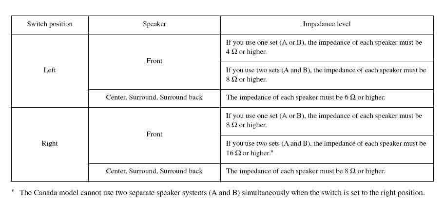

Im confused about the impendance switch though:
What side do i need it on and why does it matter?

Almost always, the switch should be kept on 8 ohm. Unless you plan to add a separate amp, stay away from 4 ohm speakers. The Yamahas do not perform well with them.
Thats not entirely accurate. You can't just go by speaker impedance, but efficiency as well. In many cases a 90dB SPL @ 1 watt efficient 4 ohm speaker is an easier load than an 8 ohm 87 dB SPL @ 1 watt speaker to drive. You also have to look at the impedance/phase profile for the speaker since an 8/4 ohm rating is nominal and not representative of the actual load the amp sees. For example my RBH T2's are rated for 4 ohms, but look very resistive to the amp since they maintain a relatively constant impedance with phase swings no greater than +-30deg across the audible spectrum. They are also 90dB efficient.
In addition, Yamaha receivers such as the Z9 have no problems driving 4 ohm speakers, even the less efficient ones, especially when being crossed over to a dedicated sub as most do in home theater.

"Some Receivers have an impedance selector switch. DON'T USE THEM! The manufacturer puts them there for UL approvals as well as easing consumer concerns about driving low impedance loads. These switches step down voltage feed to the power sections which will limit dynamics and overall fidelity. Keep the switch set for 8 ohms regardless of the impedance of your speakers and ensure proper ventilation of the Receiver. " - Hooking up 4 Ohm speakers to an 8 Ohm receiver
That switch is just for the manufacturer, mainly, i take it?
