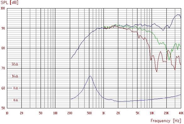

Xt25
Nominal impedance [ohm] 4
Voice coil resistance [ohm] 3.0
Nominal power [W] 140
Short term max power [W] 950
Long term max power [W] 400
Operating power [W] 5.3
Sensitivity [dB] 91.5
Frequency range [kHz] 1.5-40
Free air resonance [Hz] 500
Voice coil diameter [mm] 25
Voice coil height [mm] 2.2
Air gap height [mm] 3.2
Voice coil inductance [mH] -
Eff. diaphragm Area [cm²] 5.4
Moving mass [*] 0.30
Magnet weight [*]/[oz] 240/8.5
Force factor [Bl] 2.5
VAS [l] 0.017
Qms 2.50
Qes 0.71
Qts 0.55

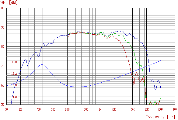

P13wh
Nominal impedance [ohm] 8
Voice coil resistance [ohm] 5.7
Nominal power [W] 40
Short term max power [W] -
Long term max power [W] -
Operating power [W] 6.3
Sensitivity [dB] 88
Frequency range [Hz] 60-5000
Free air resonance [Hz] 60
Voice coil height [mm] 14
Air gap height [mm] 6
Voice coil inductance [mH] 0.7
Eff. diaphragm Area [cm²] 86
Moving mass [*] 7.5
Magnet weight [*]/[oz] 415/14.6
Force factor [Bl] 6.0
VAS [l] 10
Qms 1.38
Qes 0.43
Qts 0.33
