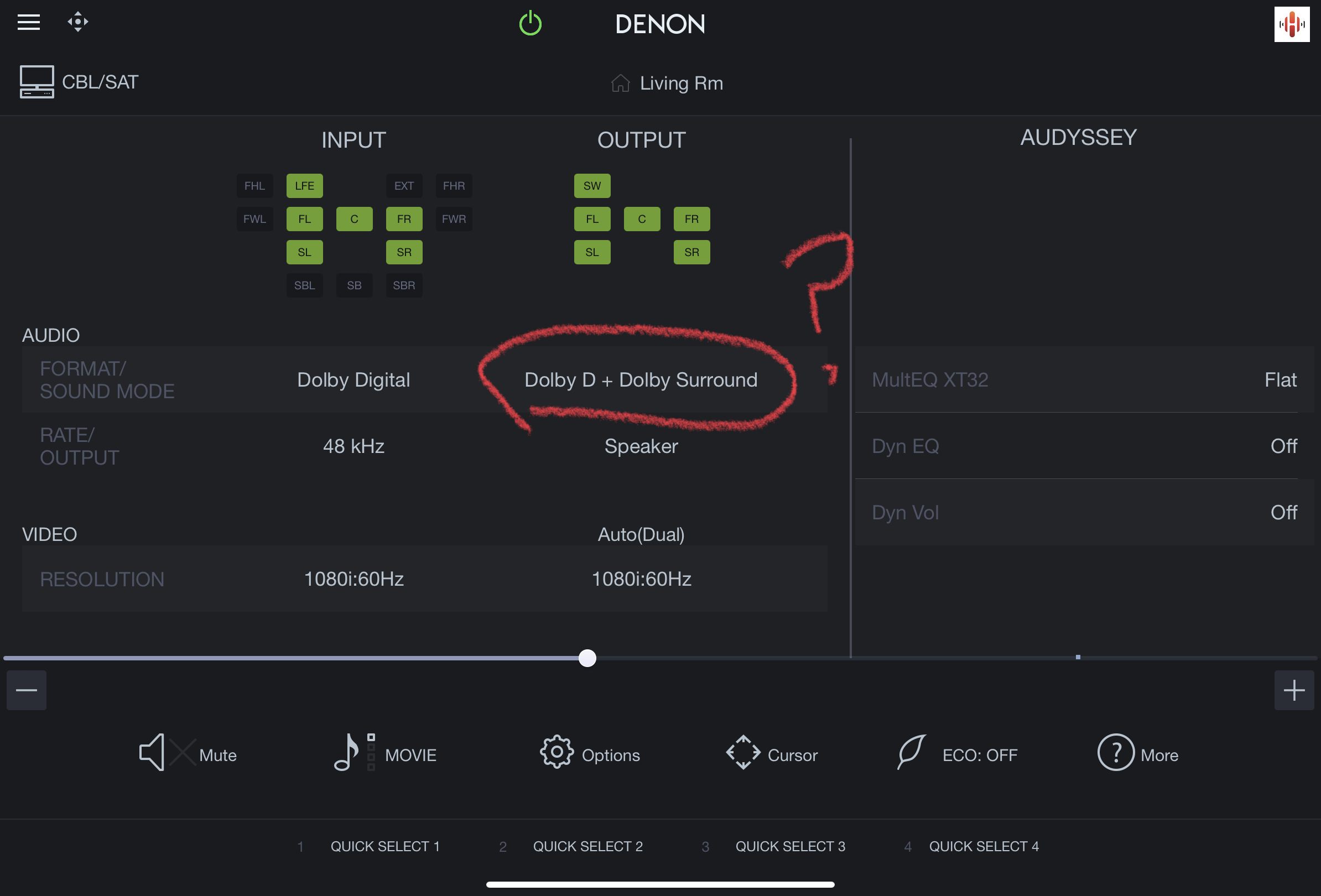

does anyone have an answer why my receiver does this for the sound mode?
I’ve the same on my Denon 2015 model and has been that for several years. I think it came after a firmware update.
It does not happen every time I turn on the receiver.
Pushing a sound mode button on the remote will then select the correct one. I’ve added that to my Harmony remote.

Wait wait wait. So your are telling me thats not the correct surround sound format For my direct tv? And i can just get regular DD?
I’ve a 5.1 setup myself and often I get a surround mode for upmixing to speakers I don’t have.
