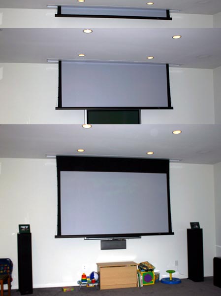

I have the setup you describe but it is in a dedicated room. I have a 42" LCD wall mounted and then an 84" electric tab tension screen that drops down. I'm very happy with this setup. Having the TV for SD content and when just hanging out saves bulb life and makes the room serve more than one purpose.
Pics of my setup are in my sig.

Highly recommended for the non-dedicated setup or for those versatile rooms which may see a LOT of TV use with lights on. We have dismantled this setup and relocated the screen to our basement rec room where it (in a few weeks) will drop in front of a 52" Sharp LCD.
One touch and the 'TV' becomes a theater...
