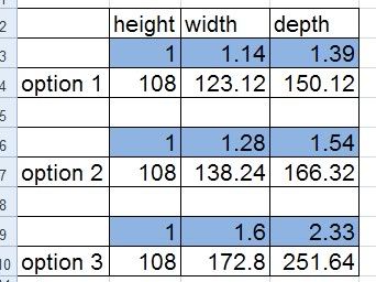

i'd like to simplify the room by
1) changing the length so it'd be rectangular (and closer to the recommended room ratios)
2) smaller so it'd be easier to pressurize and have more room gain
help?
these are the golden room ratios as it relates to my room height of 9 feet (108")

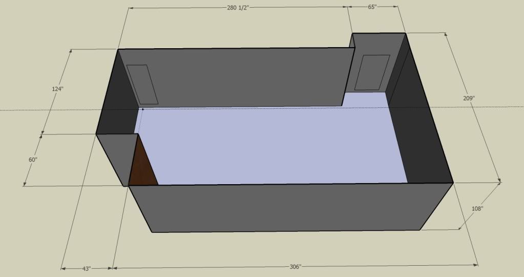

these are the room's actual measurements
the rectangular thingies on the left and right are doors.
PeterWhite
I'd forget the ideal room dimensions business. The smaller you make the room, the bigger the peaks and nulls. I would look at the room's irregular shape as an opportunity. The 43" difference in the length means that neither dimension is creating reflections all by itself. They're competing, and canceling each other at many wavelengths. Use the large space for base trapping. The thicker the absorption, the lower in frequency it's effective.
mperfct
mperfct

thanks, the room is oriented like so right now:
(those are gik traps)
but i'll tear up the cabinets so i can go wider

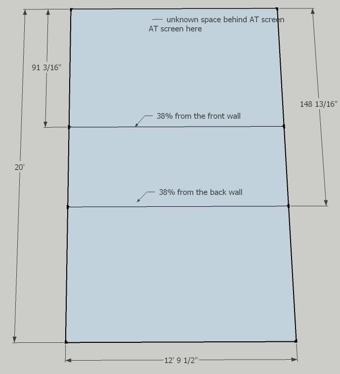

i am now heavily considering the AT screen.
i am also considering moving my HT into another room ...
above are the dimensions ... following the 35-40 degree rule, i'd have a +-100" screen if there is a 24" space behind the screen.
any ideas?

mike, I vote to be seated at the farther 38% point (closer to back wall), if only to further reduce the chance of seeing any funky effect with the screen material. I think there may be other pros, and other cons, but just that alone could make it decisive for me.
As you remember, I was buggin' rmk with 20 questions, and I'm sure you remembered his response to the minimum distance desired from screen. In your case, now that I think about it, I think you must use the second line with AT. No choice in the matter.
It is no longer relevant to the discussion here, but none to extremely few actually get 2.8 gain with the HP. And it's not just about lumens, and ambient light, but also screen size. To find your FL, simply divide lumens by sq footage of screen.
