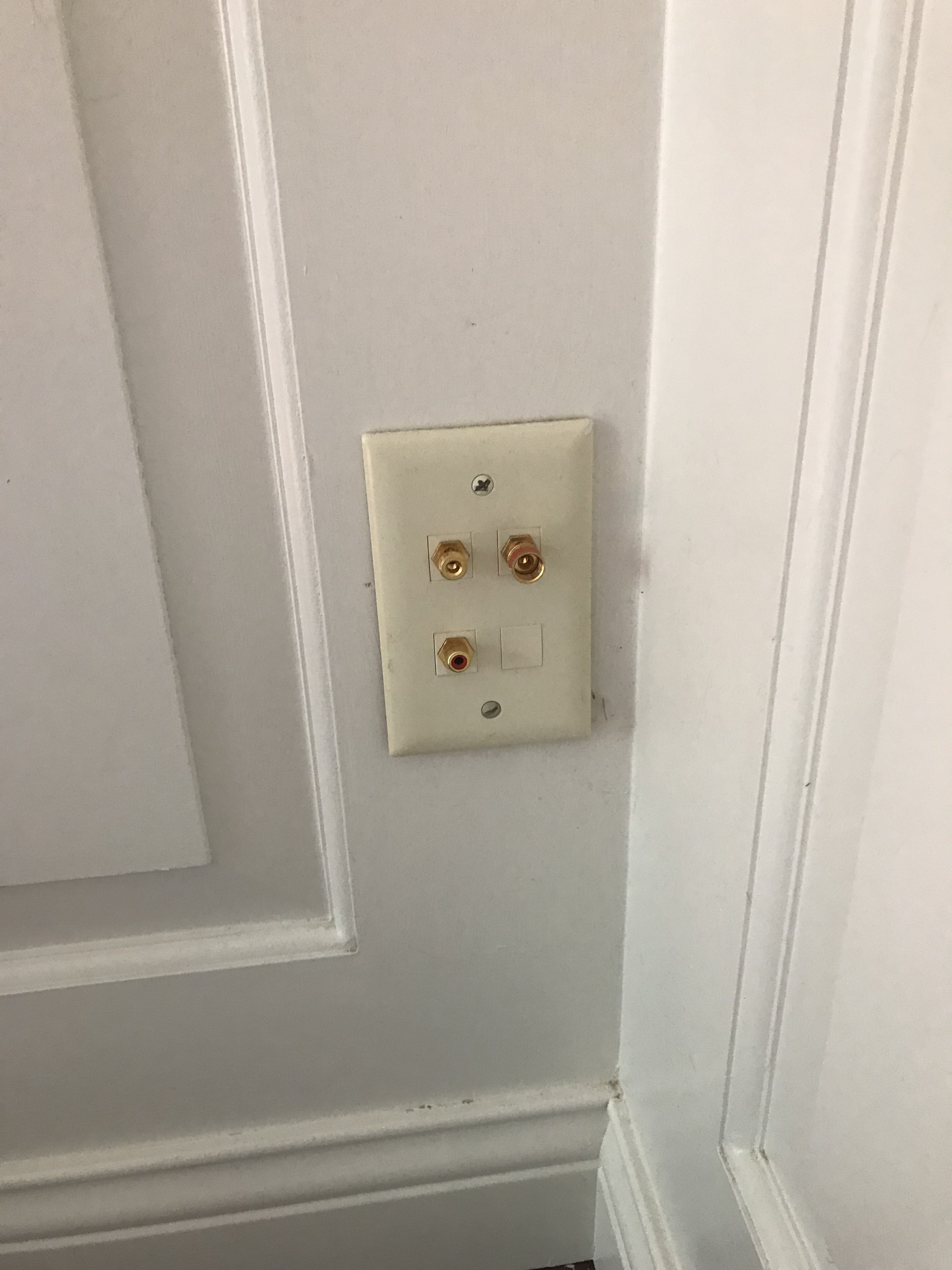

Ok so I know virtually nothing about home audio set up, especially when I have not done the initial install... I just bought a house we moved in about 3 weeks ago and the living room already had 6 total speakers built in flush to the walls (all 6 speakers look exactly the same so I'm not sure if it means no subwoofer or not). Everything runs to the picture I am attaching. My question is how exactly do I go about getting it all to work? I have gone to best buy and I believe there is a 7 channel receiver (Pioneer VSX-834) I need to get but I am unsure outside of that what I need. Every video I try to pull up shows connecting speakers that aren't built in....is it as simple as just connecting speaker wire from the receiver to these plug ins? or based off of the picture is there anything else you guys could recommend I do or would need. Like I mentioned all the speakers look the same so I assume no sub, but the connection says subwoofer so I'm not sure if I need to purchase one separately. Thank you so much for any advice, also I can post more pictures of the living room set up tonight if that would help as well.

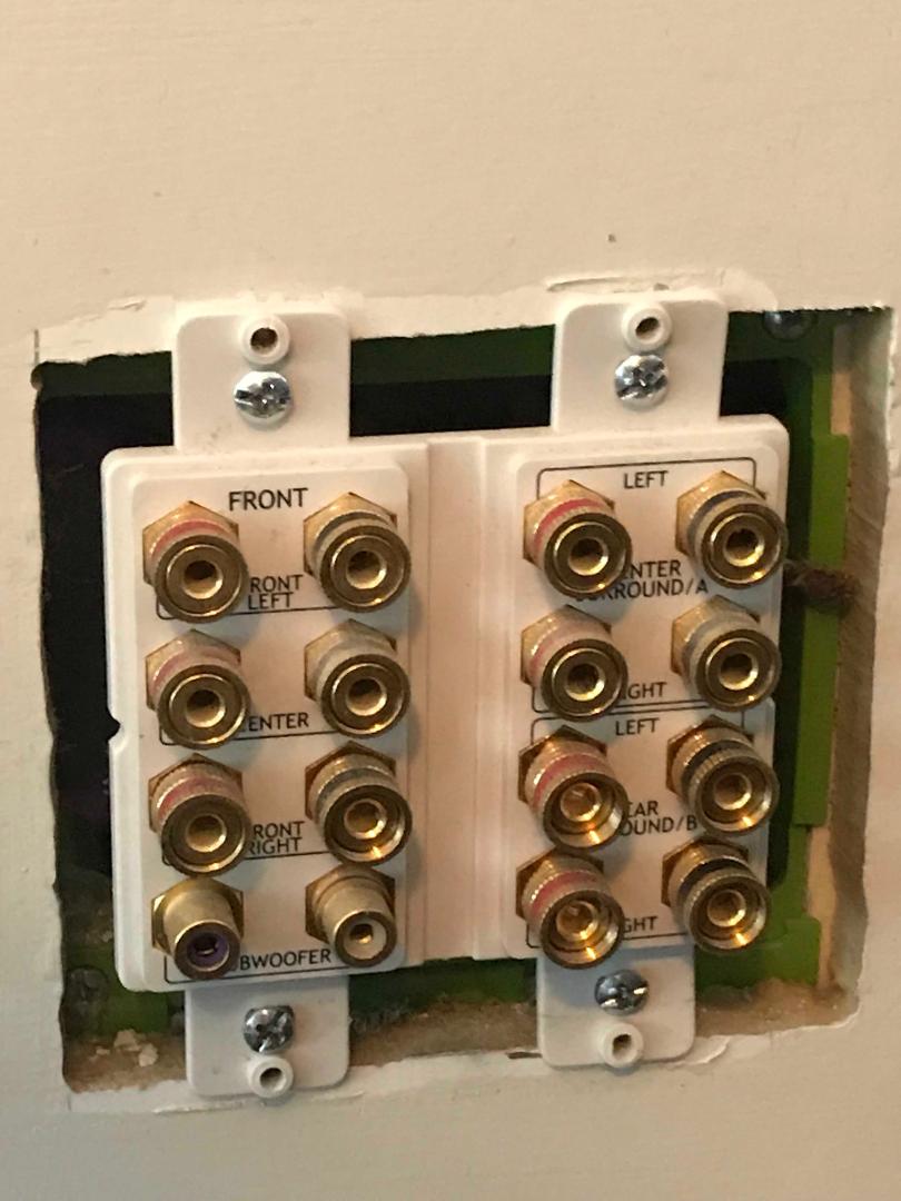

Looking at those plugs, you should have 7 speakers in there. The subwoofer plugs should only go to some other subwoofer signal jacks somewhere else in the room, but they aren't going into any installed sub. It looks like you will have to add a sub. If the wall speakers are wired to those plugs, all you have to do is hook up the speaker wire from your receiver to the wall plugs shown there. Use banana plug tips on the speaker wire.

I just double and triple checked I swear I have only a total of 6 speakers and I also have two different connections one on the far left wall and one on the far right, I am assuming these would be the subwoofer plugs you mentioned?
If you have six are they all left/right? Maybe the center was nixed after wiring? Maybe they had a separate center?
Having separate subs seems likely, and seems you've found the different connections (for rca plugs). The avr you mention should work...altho it'd be nice to know just what the speakers are.

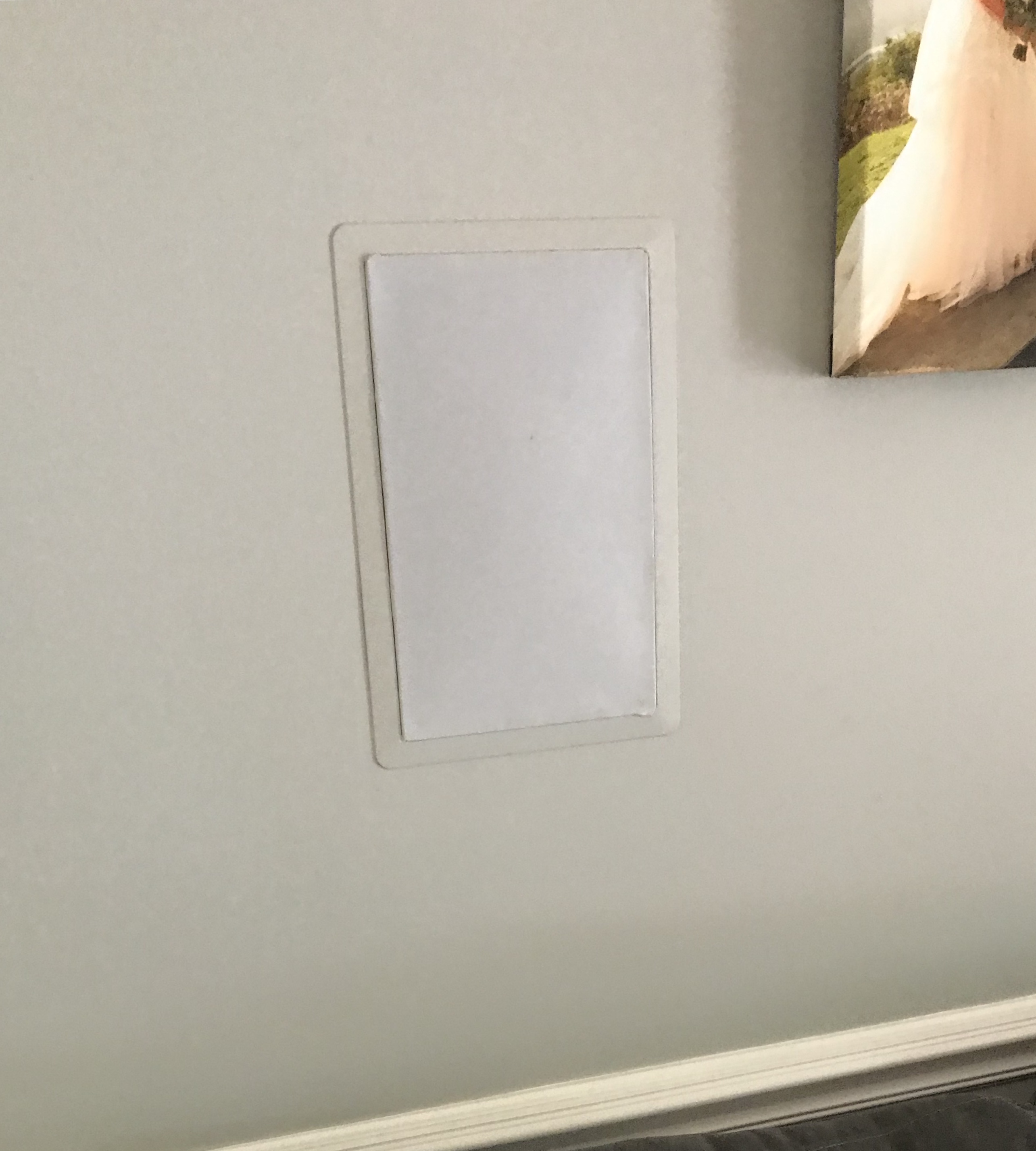

They all appear to be left/right and like you said maybe they didn’t go with a center the console I posted would be the center of the room where the tv is....all the speakers look like the picture attached they are just spread throughout 3 different walls in the room left right and back wall. I also attached a picture of the other connections I have on the right and left walls would this be for the subwoofer I’d buy separately?
I meant what make/model each speaker is. Does look like an rca connector in the second pic on the bottom, curious why there's what appears to be speaker terminals as well, tho....

Do you have any audio gear to test the speakers/connections with now? Yours doesn't sound as convoluted as some with combinations of single and pairs of speakers in various rooms and odd controls....yours is just a simple surround system it seems.

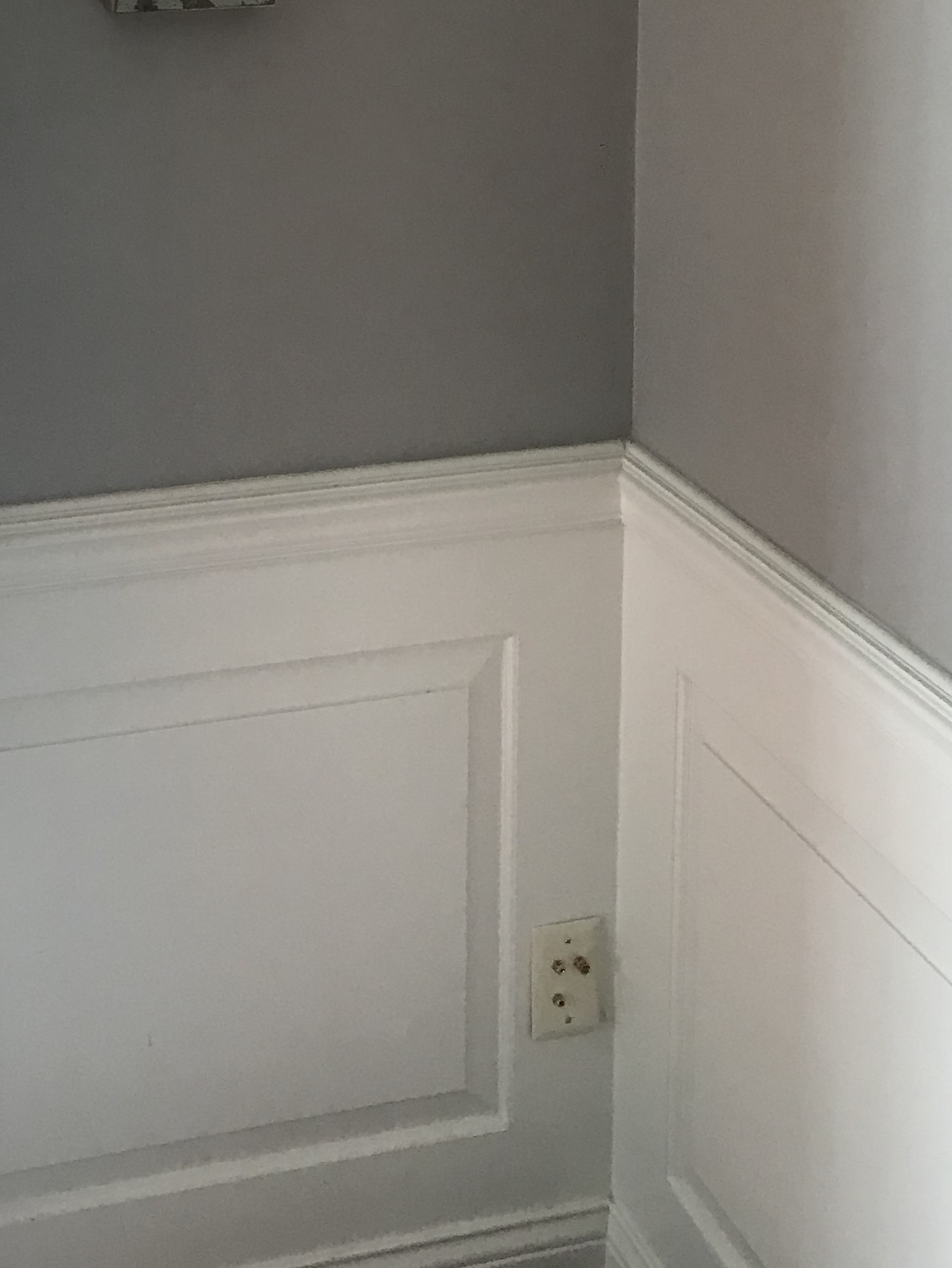

Yeah that’s what I’m hearing from others too that center is preferred....as for the sub does placement matter? The picture attached is on my far left living room wall would this be where a sub gets connected and then i hook up the receiver to the sub connection behind the tv on the wall plate?
Sub is specific to a room as far as placement goes. Whether where it's wired closest to is a good spot...hard to know. You can look up subwoofer crawl....but measurement gear is better (but probably beyond your interest at this point I'd guess). Some avrs help integrate subs better than others (I think Audyssey does a good job).

I would probably unscrew the main wall plate and see what audio connections are behind there. I expect you will see at least 12 wires (6 pairs really) connected out to the room speakers, then another 2 coaxial cables which run to the subwoofer locations on the left/right of the room.
I would pull off the left/right locations as well to see what was connected behind there. It makes ZERO sense that there are 5-way binding posts (normal speaker connections) at the wall plates, but it is something I might do if I started with in-wall speakers but wanted to go to floor standing speakers later. I might wire the in-wall speakers in series with the wall jacks. So, maybe those come from the main left/right speaker locations.
How to check?
Get a short piece of speaker wire with two conductors. You can use an old power cord and cut it back if you have that around. Connect one end to the binding post on the wall. Red & Black. Now, on the other end of the wire, tap it to a battery. A 9 volt battery works well. If someone else is standing next to the speaker that you believe you connected to, you should hear the speaker make a small popping sound as you connect/disconnect the battery. It won't hurt the speaker.
Repeat this process for all the speakers to ensure they are all labeled correctly and wired properly.
At the speaker connections in the corner, see if you connect the battery there, if it affects the in-wall left and right main speakers. As I said, if it were me, I might connect those in series so that I could add good floor standing speakers in the future.
