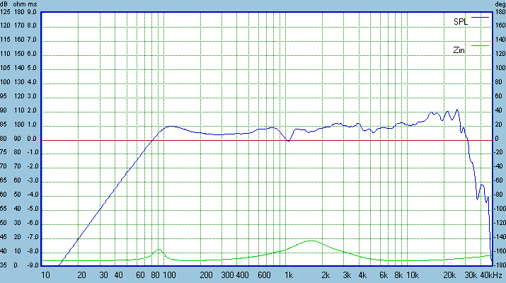

Some details I should have included- I placed them on stands with the bottom about 26" from the floor, the back a foot from the wall and 3' or more from any side wall. Also, I had them crossed over at 130Hz and all of this removes the bass issues and boundary effects. The first reflections aren't an issue and the mid range peak I mentioned was verified and countered by using his improved crossover.
I think my opinion was on track- it's a cheap speaker and for the price, it's not bad. I wasn't expecting much more than speech intelligibility for someone whose ears have been abused by his time in the military and I think they'll work fine for this purpose.

Is this is Frequency response of $25/pr speakers??... Holy crap !!
And this is before mods !!!
Obiously this can't replace $500 speakers, but can easily replace and vastly improve TV speakers
and After cheap mod:
