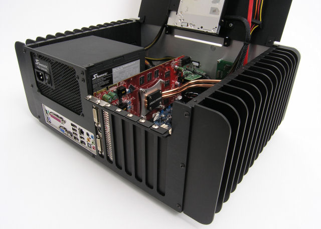

Some of the nicest cases I have seen. On the spendy side and using 100% passive cooling for the most silent HTPC ever.
http://www.atechfabrication.com/HTPC_cases.htm
Very nice! Many thanks for this link.

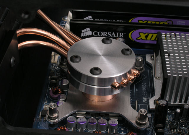

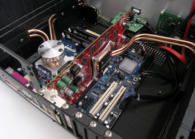

When I opened it I went straight to see if they included the cooler blocks + heat pipes to thermally connect the CPU and GPU to the case, and the DO! Excellent!
Take a look at these photos:

CPU + GPU - beautiful:
CPU close shot:
Too bad about the price. And I thought the Zalman TNN500AF was expensive.
CPU close shot:
Really cool images - I like these HTPC cases.
I need to win that California Lottery for once - I don't know why is taking so long ...:confused:
