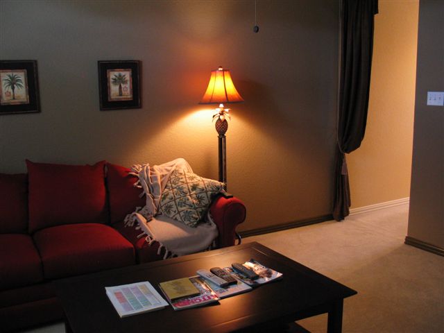

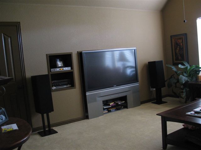

I was going to save for a bigger sub, but STF-2 at $319 is very tempting since my A/V budget is about $600 for a Sub and receiver. The room is 15x15. The ceiling angles at 7ft and flattens out at 9ft so it's definitly less than 2500 cu ft I was hoping to put the sub in the corner behind the plant. There's a small opening to the hallway, opposite corner of where i'd put the sub. I'll be adding a mid-line refurb H/K receiver later this month.
I have little kids so I wouldn't be watching movies that loud at night anyway, but it would be nice to have some wow factor in reserve for demo material. I also listen to a lot of music in there. You think STF-2 fits this description?

Off topic, but I really like how your TV is recessed into the wall.
What kind of speakers are those?
mkinder
Audioholic Intern
The guy who lived here before us had his 65" Sony recessed back into the wall like that. This 62" mitsu isn't an exact fit but it's not enough to make me re-do the cavity.
The speakers are DCM Monitor series CX-27's. I got them at Circuit City 15 yrs ago, they've literally been used almost everyday since. Really a great speaker .. smooth highs and pretty punchy for 6.5 driver. Very easy to listen to. They've been paired with the same H/K 3600 since I bought them, but now it's time to add a sub and get a modern AVR. I'll keep the DCM's as mains and build around them until they give up on me.
