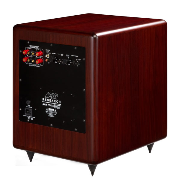

If we take a look at the rear panel of the module, we will find the usual controls like power mode, crossover frequency setting, gain/volume, crossover's bypass, phase, and a nice speaker (input/output) section. So there you have it, guys. It sure looks interesting to be honest.

Click on the following thumbnails to zoom in.
