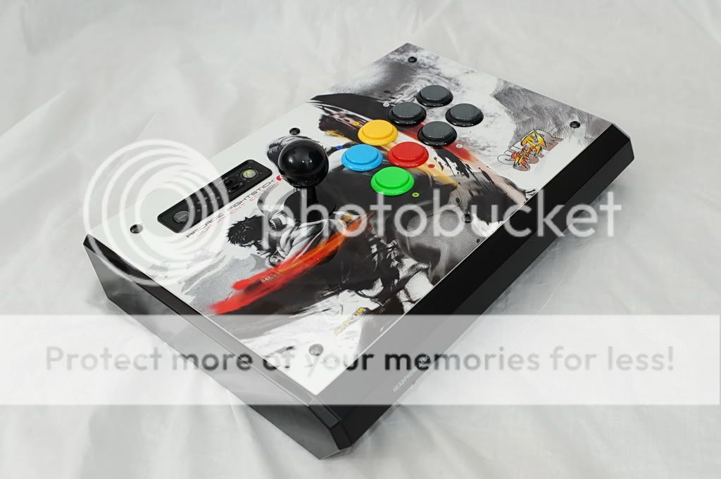

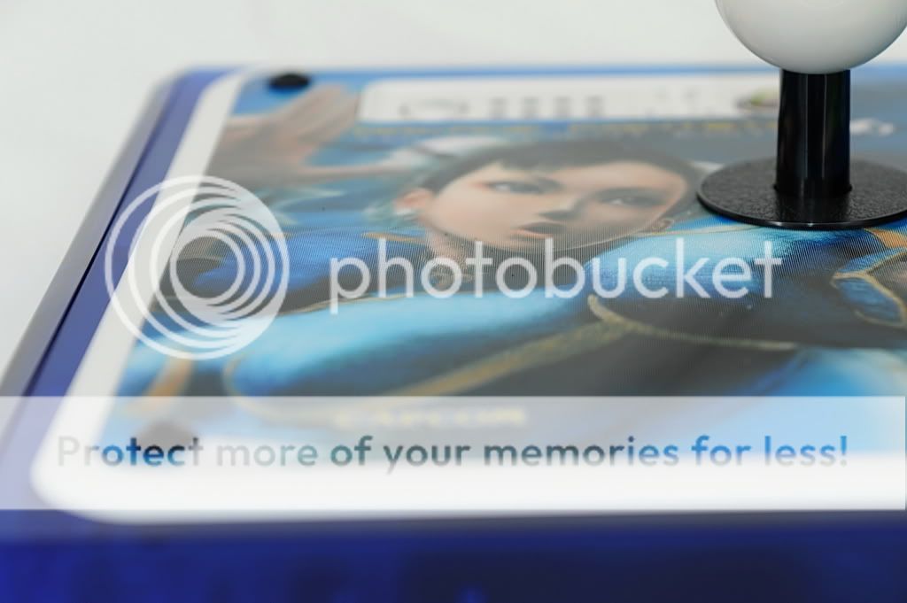

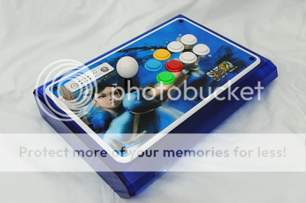

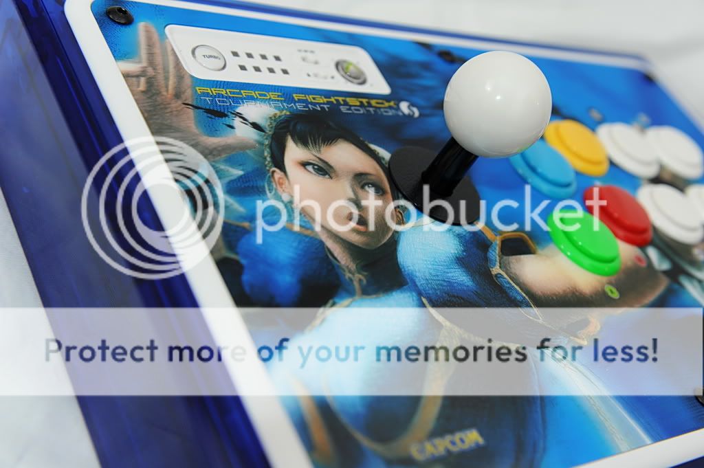

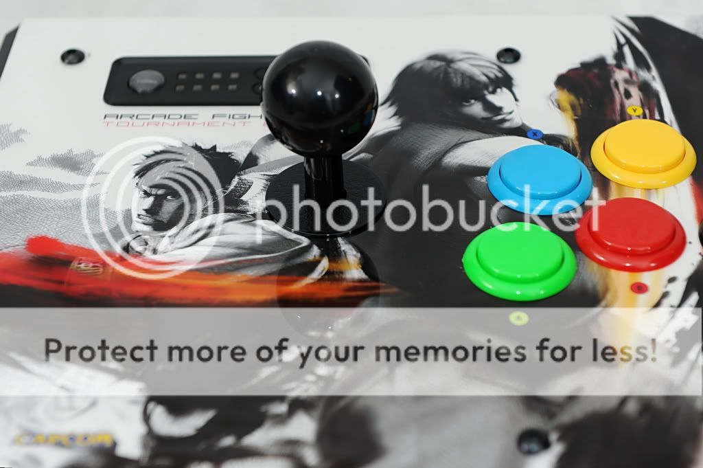

Thanks! Here are two more that I got a few days ago. The third has yet to be photographed, just been lazy :)
Chun Li one is the most beautiful. Notice the lenticular 3d art...

Nice. Have you looked into modifying or building your own sticks?
The two I have (both for the ps3) are the Hori Fightstick 3 (Soul Calibur IV edition) and Hori Real Arcade Pro 3-SA.

No I haven't.
Mainly because of time, no past experience and the fact that the TE sticks are pretty up there with high end sticks...i know the SC4 arcade stick, I bought that one back then but returned it as it was too light and small for use...weight was the main factor and build quality didn't seem up there, although i am obsessed with the soul calibur series :)

Yeah, it would be pretty pointless to mod one of the high end sticks unless all you wanted to do was change how they look :)
And yes, the SC4 stick is very light. The HRAP3-SA is much heavier and overall much higher quality.
