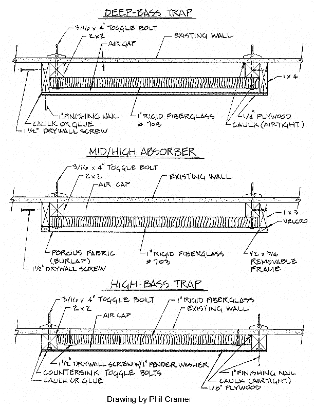

Hey Guys! I'mmm bbaaaccckkk... Sorry, couldn't resist.
Anyways, the HT Room is almost done. Sound was harsh at first, but then built and install six "mid/high" acoustic panels, 2 with 4" 703 and 4 with 2" 703 Rigid Fiberglass. Did alot to reduce reflections and tell you the truth having a hard time hearing a "problem" now... Sounds great with a $500 Pioneer Receiver and Energy Take One Speaker system...
But, I still have 3 2x2 2" 703 left. So thought I'd make a Bass Trap. Saw this one online and thought I'd see what you guys think - 1/4" plywood seems pretty stiff in a 2x4 box... Was thinking of installing it behind the couch - bass frequencies with their long wavelength go through couches right? There just not much wall space left in the room...
W
westcott
Glad to hear your investment in room treatments have paid off.
Ethan is pretty sharp fellow when it comes to this kind of stuff. Sure worth a try although the greatest benefit will be derived with traps placed in corners and directly behind the subwoofer. Next in importance would be room intersections.
