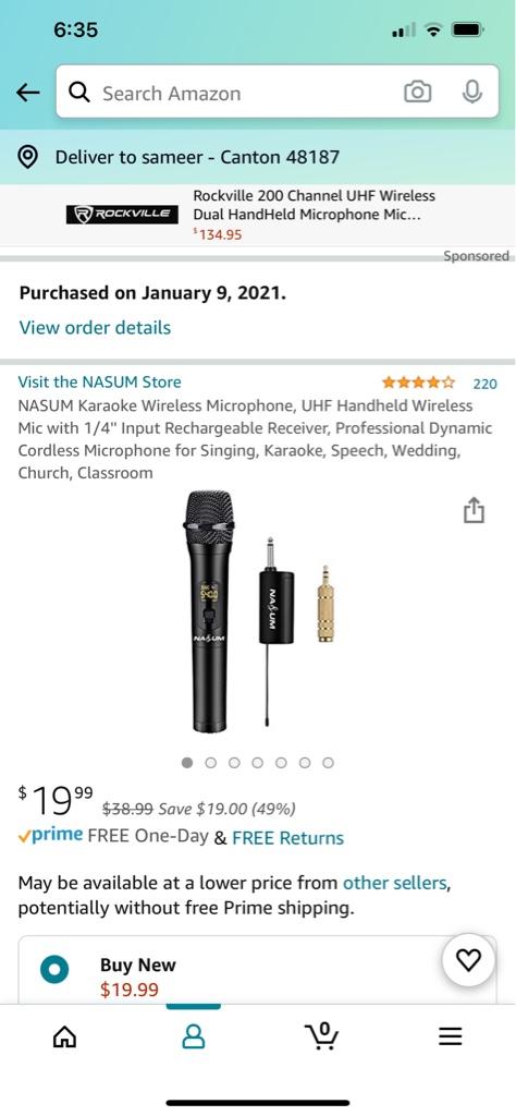

This mic, I though I can plug-directly to av receiver but seems that’s not the case

This is the product page it looks like:
It is a VERY valid question to ask how you are connecting this to your AV receiver or equipment. If you can take a photo with your phone and post it directly or if you can fully describe how you are connecting it. The 1/4" jack output of that product is not typically an input connection on any AV receiver on the market, so it would be necessary to get a 1/4" mono to dual RCA adapter to make this work right.
If you are just plugging it onto the 1/4" jack on the receiver (which is designed as an OUTPUT FOR HEADPHONES) then it won't work for darn sure.
If the product came with the 1/4" mono to 1/8" stereo adapter, then all you need is a 1/8" stereo to RCA cable like this one:
My guess is that you don't have it connected properly. Since you didn't say exactly how you connected it to your Onkyo, the it is just a guess as to what may be wrong.

Plug it into 1/4 jack, seems that’s the problem after your explanation, I will order the RCA splitter and try out, thanks a lot for help.

That definitely is the issue. AV receivers don't have a 1/4" input jack for microphones. This is why you need to always read the manual for your product. I expect that they think you will be hooking up that microphone to a standard karaoke unit which typically does have a 1/4" microphone input. But, AV receivers typically only have a 1/4" HEADPHONE OUTPUT. This is pretty clearly described in the owner's manual.

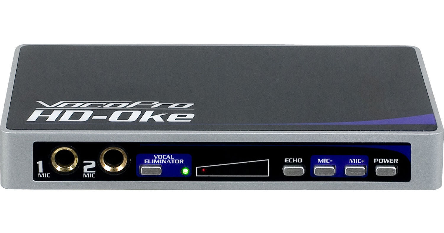

It should also be noted that AV receivers do not 'mix' audio. So, you can't have loud background music playing and being mixed to with the microphone. That's not how AV receivers are designed to work. You get microphone audio, OR you get source audio. You don't get a mix of the two. If you want video on screen along with audio from the source along with microphone audio from someone singing, then you will need a karaoke machine, or mixer which will accomplish this for you.
It is VERY IMPORTANT: Let others know what your desired end goal is. While you say you want to hear audio out of your AV receiver, you also mentioned karaoke, which then tells me that you may want a mix of audio and video out of your system.
To accomplish that, something like this is actually, and very specifically what you may want:
That gives you a proper 1/4" microphone input along with HDMI video/audio in/out which should give you a mix of everything on screen and into your receiver.

As BMXTRIX posted, look at VocoPro for this- they make good ones
