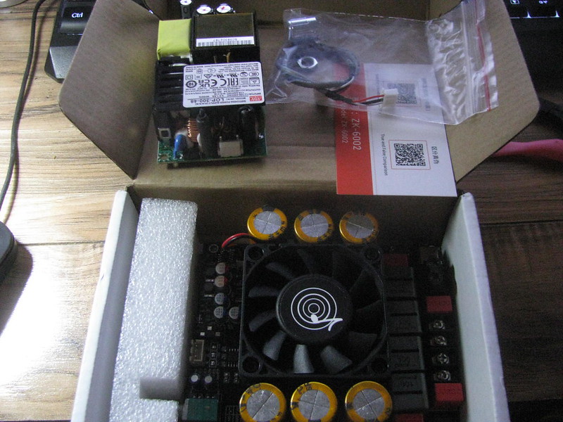

The hot chip now is the TPA 3255 and it too, sounds excellent. I own some of the chips and I bought this Chinese module and a 48V SMPS to go with it. I am thinking about making a semi-portable boombox with this one, when the mood strikes me. For now, I have too many audio toys to play with. I have another module with the LM3886 somewhere around here, as well.

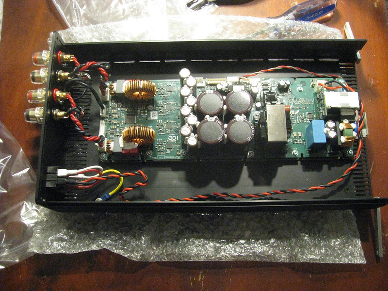

Here's an ICEpower, ICEedge based power amp (1200AS2) module kit I just assembled that is mostly plug and play and this thing sounds as good as anything out there, and with gobs of power. Why do I buy kits now? Because they can include all of the hardware and harnesses typically at a substantial savings of what I could source them separately for.

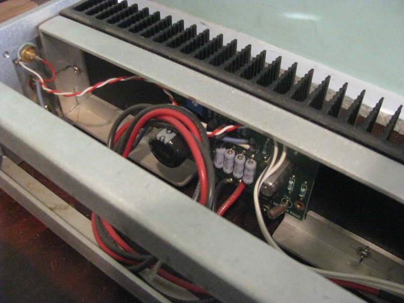

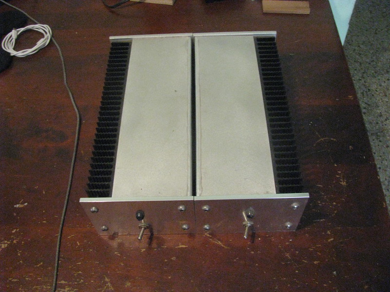

Here's a very simple pair of class A mono blocks I made based on the Pass DIY Amp Camp Amp. I just bought the circuit boards from diyaudio.com and sourced the parts from Digikey and the obsolete transistors and such I ended up getting from a friend of mine who builds ham radios who had retired from the communications industry and has boxes full of NOS parts. Amazing how good these things sound, all 8 watts of them, given how crude these circuits actually are, by today's standards. I loaned these to a friend to try and it took me forever to get them back from him. I have another complete set of parts to build another.
