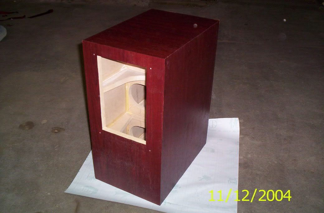

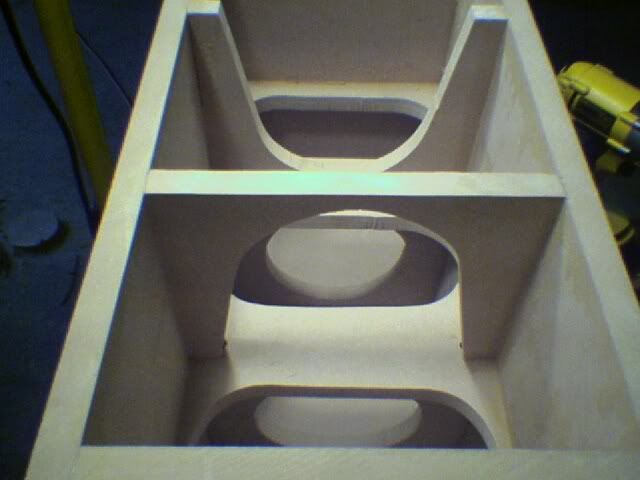

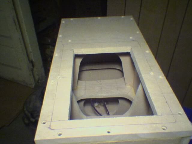

Annunaki, that is some serious internal bracing. When you have internal bracing do you need to account for it in your volume measurements? ie build a larger enclosure to maintain the same net volume?
You must account for bracing displacement.
BTW, the bracing seen in those pictures may seem like a lot, but even this degree of bracing will likely result in substantial audible resonances that distort timbre in a full range speaker. But I expect it would have a better result as compared to the average execution.
Even the extreme bracing/constrain wall damping utilized in the following picture links, while having almost no audible resonances, still has some in particular music tracks, when compared directly with a known non-resonant reference:
http://www.linaeum.com/productinfo/other/infinity_primus160_ultra/braces_back_s.jpg
http://www.linaeum.com/productinfo/other/infinity_primus160_ultra/braces_front_close_s.jpg

As Chris indicated, you will have to account for bracing displacement. I like the two way option better as it plays deeper and integrates better with a subwoofer, but a single driver option may have some useful benefits.
