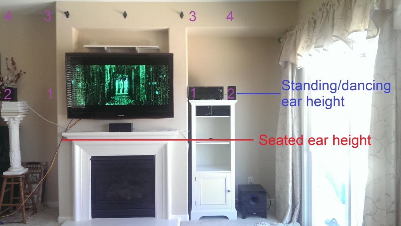

I am new to the audio scene. We have a Denon AVR-789/1909 with Energy Take Classics, but only have it connected as 3.1 for now. The goal has always been to find a good balance between listening to music and watching movies.
Originally, I attached the speakers above the TV, up near the ceiling (for WAF) and slightly angled down. I ran Audyssey, but the sound didn't fill the room enough when listening to music. After educating myself a little more, through the audioholics basics page, I realized that maybe I had the left and right speakers spaced too closely together (~4.5 feet). The central listening area is 15.5 feet away from the TV screen (image 3). Trying to do an equilateral triangle is not practical, neither is an 80% ratio.
First thing I did was try to move the speakers lower (image 1). Reran Audyssey and things started to immediately sound better. Soundstage was wider and filled the living room much better. I also didn't have to turn up the volume quite as loud as before to hear things. In image 1, the LR speakers are barely 6 feet apart (~39% ratio), but sound much better than before. I decided to keep experimenting.
In image 2, I moved the speakers 8.5 feet apart (still only a 55% ratio), but voices sounded thinner and overall volume seemed to diminish.
I know our room setup is not ideal, but I would like to learn how to work with what we have, please. Are the Take Classics too small for the room? The bass sounds good enough, and sometimes too boomy that I have to dial down the subwoofer. The speakers sound like it can't quite reach the higher notes in songs sometimes. What I mean is, listening to "Let It Go" (we watch a lot of Frozen with a 3-year-old), it seems Elsa's voice should be sounding higher when she hits the higher octaves. Not sure if it's just supposed to sound like that or not.
Wife is ok with the setup in image 1. She definitely would not want the wider speaker distance of image 2. Image 2 didn't sound as good anyways. I could probably get away with a wider speaker distance if I located it back up near the ceiling, but there's no easy way to experiment with that. From the experience of others, is having the speakers angled from the ceiling worse off than having them at the mid-height of the room (ceiling is 9 ft high)? I don't really want the speakers at seated ear-height. That may be ideal for movies, but sometimes we like to stand up and dance and music sounds better when the speakers are at 5 ft height for that.
Would we be better served by replacing the Take Classics with just a pair of larger bookshelf speakers and slowly add to it down the road? At this point, I'd rather not spend more than $400-500 and would much rather learn how to get the most out of what we have first. Once I have a better grasp of what good audio is about, then I can make better informed decisions about upgrades down the road. Thank you to those that can share their knowledge, experience, and advice.
image 1: https://www.dropbox.com/s/3s3mra3snhwgiqh/image 1.jpg
image 2: https://www.dropbox.com/s/u0v3cbyqopd0fnx/image 2.jpg
image 3: https://www.dropbox.com/s/jl4qyx8t0otha0i/image 3.JPG

Thank you, zieglj01, for the article. It was a very interesting read! I think I would prefer to experiment with bookshelf speakers for now. How do you audition different speakers? Do stores actually let you try out different speakers, similar to demoing tennis rackets? I imagine places like BestBuy and RC Willey probably are not the places to go, correct? Is it common practice for specialty audio stores to lend out speakers for you to try out? I've never been in a specialty audio store and am not familiar with the typical sales experience.
If I do find a place that carries the brand of bookshelves suggested earlier, and allows me to trial demo them at home, which positions (in the diagram below) would you guys place them? Left and right speakers at position 2 would be the least desirable, from a WAF standpoint. Just to be clear, the pair of bookshelves are meant to replace the left, right, AND center Energy speakers, correct (unless I get all three of the Ascend Acoustics originally suggested)? Thank you, all.
52" TV measures 50" wide (edges of bezel)
Position 1 and 3 = 70" apart (5.8 ft)
Position 2 and 4 = 102" apart (8.5 ft)
3db
3db
Thank you for the advice and input, everyone.
After you decide on your speakers, I would get adjustable height speaker stands that can carry the weight of your speakers and place them on either side of the fire place and move the equipment stand to the left hand side of the fireplace. This is my secondary system in teh family room. That's how I tackled the problem.
