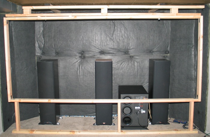

If your screen is AT then just get 3x of these Cabridge towers :) .... For next project you'd need to save twice as much as your current budget for a nice sub(s)

Hey bored...I can't figure out what "AT" means lol Sorry noob here. Please explain. And I know the budget is tight, basically shoe stringing it here. But truthfully the JBL sub is not as bad as you would think. Is it mind blowing? No sir....but it will get me by for now and let me build up the front sound stage, so I am happy.
AT= Acoustically transparent
See example below:
Good source for screens: Seymour AV | Center Stage screens - Fixed are best and cheapest. Fixed DIY is even cheaper
