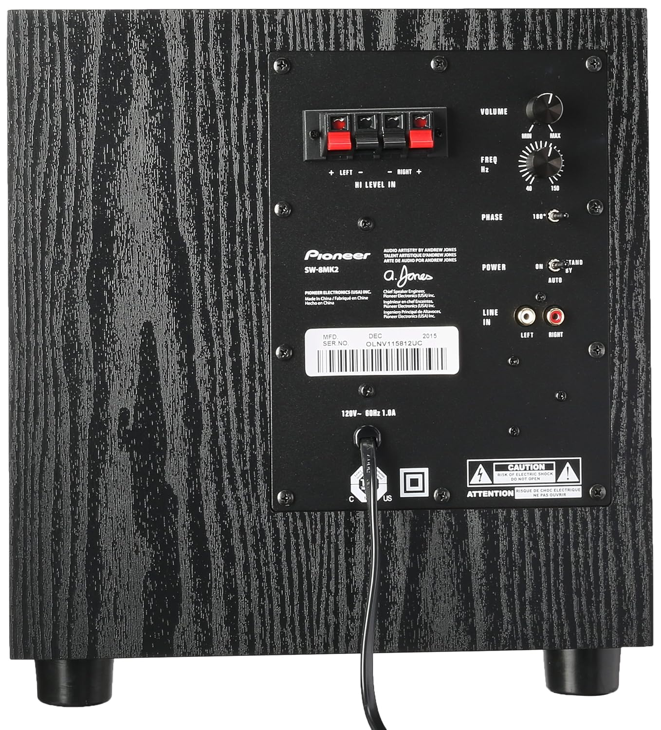

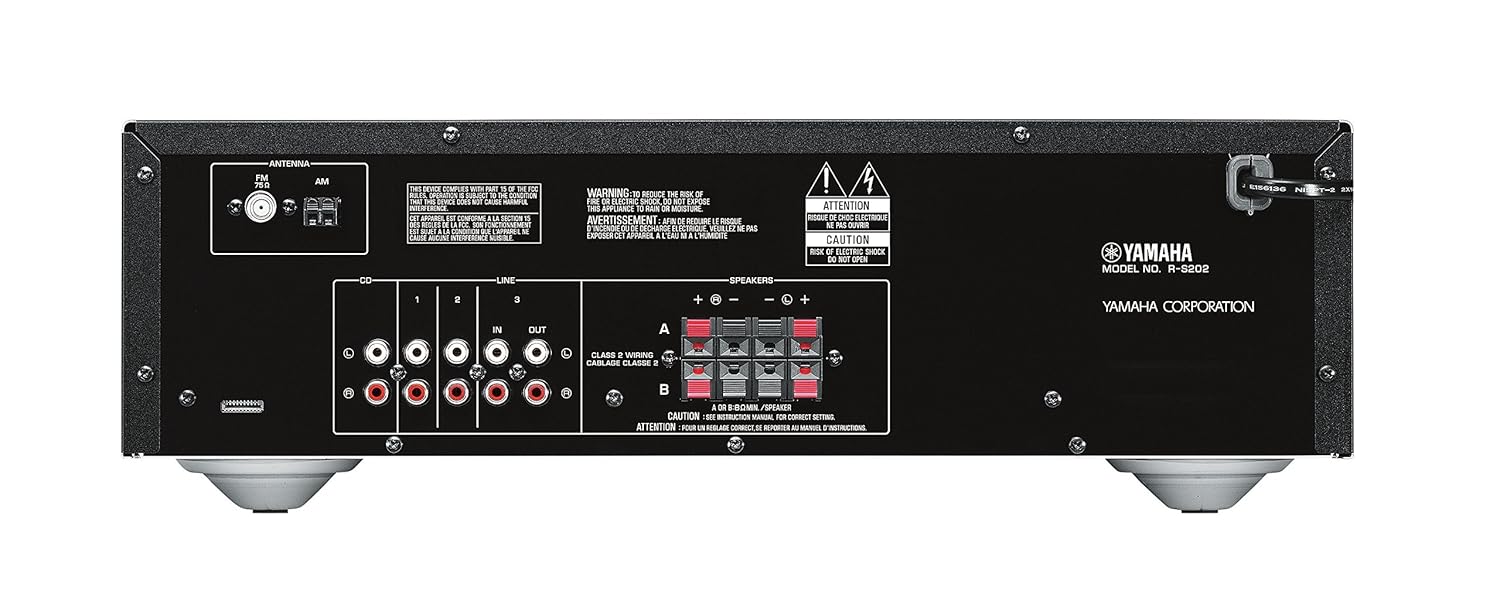

I have a stereo system for listening to records, with 2 bookshelf speakers connected to a Yamaha R-S202BL receiver. I bought a powered subwoofer (Pioneer SW-8MK2) hoping to add some low frequency range and reduce the bass burden on my bookshelves.
My issue is that the receiver doesn't have a dedicated subwoofer-out, and the subwoofer doesn't have a speaker outputs.
I am a college student on a budget (hence the relatively low-end gear). Is it possible to connect the subwoofer without replacing either the receiver or sub? Or is there some sort of post-amp equalizer (is this a thing?) that can split the lows out to the subwoofer? Looking for any advice -- thanks!

You can try to use the b speaker out on the Yamaha. So use a+b in the Yamaha

If you are only connecting the receiver to a single source, than use a couple Y-splitters like this and route the other end of the splitter to the subwoofer inputs. There is no good way to connect that sub to that receiver directly. Of course, you will have no bass management, as the speakers and sub will be playing the same band, but at least you will have some bass. You will need to turn the sub's low pass filter until it matches the speaker's roll off, so you don't get too much overlap of bass playback. You might as well do that by ear.
Oops, didn't see those high-level inputs. I assumed a low cost sub like the Pioneer would not have that. Everett is right, try to use the B speaker outs. As I said before, you will have to match the sub's low pass filter to the speaker's response by era, unless you have some fancy measurements gear laying around.

I've connected the speaker B lines to the sub and it's working. To go around not having bass management, I turned the bass down on the receiver eq and the volume up on the sub. It's not perfect, but the sound is more well-rounded than what I had before.
Thanks for the guidance, and if anyone has recommendations how to improve the current set-up let me know.
