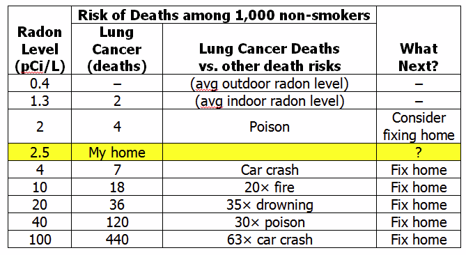

Because I recently developed lung cancer, and because I never smoked, I wondered what levels of radon radiation were in my home. I tested for it more than 20 years ago, and the test showed little detectable radiation. Radon test kits are cheap, so I tested again.
The test showed a border line low level of radiation of 2.5±0.1 pCi/L. To compare, average outdoor radon levels are 0.4 pCi/L, and average indoor radon levels are 1.3 pCi/L.
The curie is a standard measure for the intensity of radioactivity contained in a sample of radioactive material. It was named after French scientists Marie & Pierre Curie for their landmark research into the nature of radioactivity. A curie is defined as the radioactivity of one gram of radium. Radium decays at a rate of about 2.2 trillion disintegrations (2.2×10^12) per minute. A picocurie (pCi) is one trillionth of a curie or 2.2 disintegrations per minute.
My home's level of 2.5 pCi/L is border line low. But it is between 2 and 4 pCi/L. Do I leave my basement as it is, or do I get it ventilated? What would you do?

Based on the table you posted, I'd take some measures to reduce it.
I can't say how much it would be directly harmful (if kept as is) or beneficial to you (if you address it)- I'd think out of all AH regulars, you'd be the one best to judge it, but I can safely say that if or when the time comes to sell it, the new potential buyer may be turned off by it.

What's the construction of your home? Basement, slab, crawlspace. I would just get a remediation system to keep it in check if it gives you peace of mind.
If in a basement and you have windows: Crack a window open for 24 hours, after 24 hours, leaving the window open, retest.
Two issues.
Radon levels fluctuate over time. I suspect at times your Radon level is higher than that and sometimes lower. In fact it can fluctuate quite widely even from day to day, and they tend to be higher in the winter.
My advice is to remediate your home for Radon. I know that won't help you personally, but you are not the only occupant.
Over time the advice gets to be more and more aggressive about Radon gas.
Radon is the second biggest risk factor for lung cancer after smoking and you are one case in a home with at least one marginal Radon reading.

In answer to some questions:
  • My house was built in 1993. I've lived there ever since it was finished 30 years ago.
  • I have a full basement with poured concrete walls and floor.
Some background history on radon in my neighborhood:
  • Most of the houses on my block were built within a year of mine.
  • None had basements with radon ventilation, as built.
  • One house, next door to me, later had its basement ventilated when it was later resold, about 20-25 years ago. As a result, most of the people on my block (including me) got test kits and did the 3-day monitoring for radon. All resulted in negative or border-line low results. The owner of the house with the new vent system later told me his basement was also border-line low, but his wife insisted on getting the vent system.
  • No one on my block, other than that one house, installed basement ventilation systems.
My recent test results were no different than what I found about 20-25 years ago. Despite my lung cancer, I doubt if I will install a basement ventilation.
  • I will do another 3-day test later this spring or summer.
  • I will get an estimate of how much it costs for an installed basement vent system. Depending on the estimated cost, I might reconsider and get it done.
