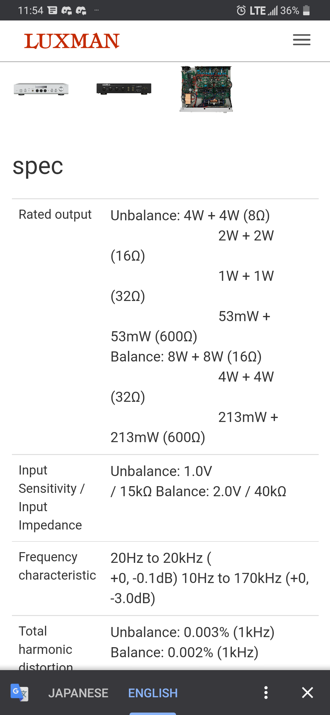

Also, can someone explain where do I find continuous and peak power specs on amplifiers or how do I calculate them? Or is that usually not revealed?
Let's use this as an example.
It states that the AMP provides 4+4=8 watts of power into 32ohms through the balanced output. I'm assuming the 4+4=8 watts is continuous, how do I calculate peak power based on that specification?

If you really want a true value for continuous power, the best bet is to measure it yourself. Aside from that, find a trusted source that does their own measurements (Audio Science Review, for example).
See, this is (one of) the problems with 1st party specs and power ratings! Unless they tell you the conditions of these ratings, then you must take them with a grain of salt. So, when they give you a power rating, is that peak or continuous? RMS power? (Note that RMS power is a mis-nomer, it has just stuck around long enough that it is accepted now, root mean square for a power rating is completely meaningless, RMS only has meaning when looking at electrical signal like voltage). Is that the power over the full audio band? Or at 1kHz (a very common choice)? And, VERY IMPORTANT-- What is the THD+N for that output power rating???

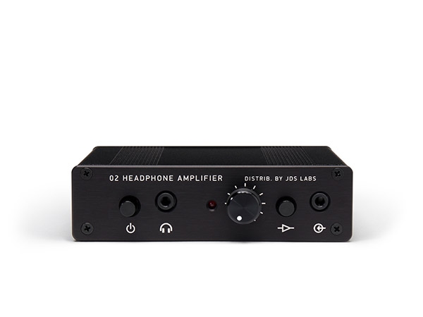

Now, to get to specific headphone amps. Most of us on here and many other websites are going to tell you to get a JDS O2 and be done with it.
Beyond that, personally I would be looking for an Oppo HA-1. This is no longer produced, and still commands about $1k on the used market.
Edit: I can't remember if the O2 is class A or AB, but I also would not get too caught up on that.
As mentioned before, don't assume any rated power output specs are "continuous" unless stated clearly as such and with all pertinent information such as THD+N, and their definition of continuous. In most cased, "continuous" in such context usually mean the following:
- Tested with a continuous sine wave, e.g. 1 kHz sine wave.
- Tested for duration of seconds, or minutes.
Even for some heavy class A, AB power amps, their rated so called continuous outputs are not truly/literally "continuous", but for minutes, perhaps up to a few hours (though that would be rare).
For the calculations you seem to be asking about, it is quite encompassing so unless you can narrow your question down to a specific condition, your best bet would be to take a look of the following site and if you still have questions then come back and ask again. The sengpielaudio website has pretty much all the formula you would ever need for audio amplifier related calculations.
