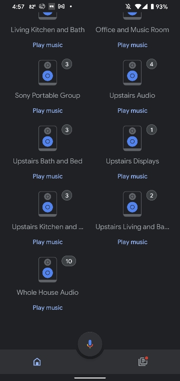

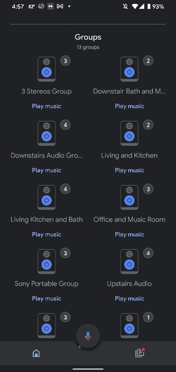

alvester
Chromecast Audio works best for our home. I have speakers with Chromecast audio built-in in 1 bathroom, a dining room, 2 bedrooms, the garage, also Google Nest Audio (which is basically Chromecast Audio) in another bathroom and my wife's home office, add-on Chromecast Audio dongles on my home office desk's self powered speakers, on my piano's self powered speakers & attached to my main stereo's preamp. I also have a NAD integrated amp with Chromecast Audio Built-in located in my drum practice room. Our Sony ES Home Theater Receiver also has Chromecast Audio Built-in.
All these devices can be controlled with voice commands using Google Assistant found either on the various Google mini devices throughout our home or on our phones or on our 2 Google Nest Audio devices.
All the various devices can also be controlled via the Google Home app from our phones or Android tablet and/or Chromebook as well as be grouped into various collections of audio device groups for playback in multiple rooms. We can also send audio from the Chrome browser on our desktop and laptops to our home's Chromecast audio devices. I've created 10 different distinct Chromecast Audio groups to cover different playback situations in our home.
