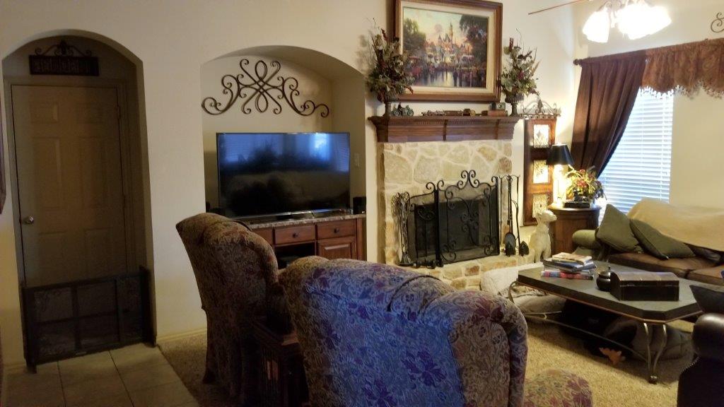

The sitting area is 20x15. I have 2 recliners thst are 10' or less from the tv, couch is about 10-15'. Yes the room is open to the kichen & nook. I mainly listen to rock. I have up to $1200 to spend on speakers and a sub just wasn't sure if it took that to get good quality sound? Thanks again!

Wow, that is a tight space. Does it measure exactly 6"? You could try Focal Birds which are 6-9/16" wide. They also offer more placement options.

After seeing the pic. of the room I'm thinking soundbar. You can get a mount to place a soundbar on top of the tv.
https://forums.audioholics.com/forums/audio/sound-bars.51/
https://www.amazon.com/Impact-Mounts-Universal-Soundbar-Speaker/dp/B00JMWF3AE
Or
https://www.amazon.com/Stanley-ATS-124-Shelf-Large-24-Inch-Width/dp/B00T8U6CHS/ref=sr_1_17?s=electronics&ie=UTF8&qid=1515084617&sr=1-17&keywords=tv+mount+for+soundbar

Gotta laugh at how architects just LOVE to place the TV locations in such awkward spots for proper viewing/listening. One of my pet peeves for sure.
In your situation, my suggestion would honestly be for a 2.1 setup like the SVS Prime Satellites + one of their subs. They're $135 each and honestly can really jam. They have a basic 2.1 kit that includes an SB-1000 for $699.99, (https://www.svsound.com/products/prime-satellite-2-1) I've seen them let customers swap it for a PB-1000. Honestly if you can fit it in though, your room might demand a larger sub due to its dimensions. Still, even an SB/PB-1000 plus the SVS Sats would absolutely smoke the setup I see in your picture.
EDIT: FWIW, the SVS Prime Satellite dimensions are 8.75" (H) X 4.9" (W) X 6" (D). They've been just the right tool for the job with many of my customers who were stuck with a less than ideal offset layout. With a stereo pair of speakers, one thing that is nice is how you can toe them in/out to get your stereo imaging dialed to your main listening position. That's the one downside to most soundbars, although a sound bar may honestly be the right way to go in your situation if you can't find traditional speakers that will work out for you.

I was going to lift my tv 6 inches to accommodate something like the SVS primes and lay them on their sides and buy a center channel and lay it on top of a sub. Any concerns with that set up?

I feel your pain. I have a very expensive hutch we bought for another house that let me have floor standers next to it. New house, not so much. Ended up going all in-ceiling which actually sounds pretty good for what it is. Wouldn't have done it had I not two other rooms with full surround systems.

I like this idea. Not sure laying on their sides will be great for imaging, but I don’t see a sweet spot so I would definitely build/Buy/find a riser to go under the tv.
