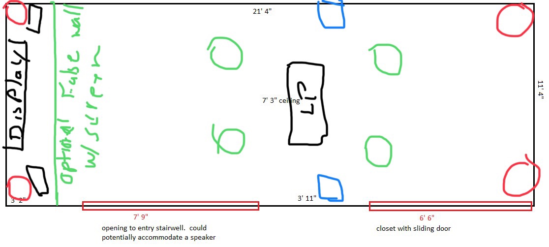

Hello all. I'm starting to put together a plan to turn the kids' basement playroom into a home theater. I've attached a rough schematic showing some limitations. The room has a drop ceiling and the adjacent room (to the south) is unfinished utility room, so I should be able to run wiring anywhere. There are five of us in the family, but I may end up starting with the kids on bean bags (in the event I decided to elevate a second row). I'm planning for the room to be 7.2.4 (although it won't all happen at once).
Mostly I'm trying to figure out:
  1. Where should I put the TV/screen?
  2. What would you do with seating?
One last restriction: speakers on stands for surrounds is a no-go (kids are still pretty young). Let me know if I left out any pertinent info. Thanks in advance for the help!

If this was my room (without having seen it) I’d prob go with building a false wall on the right side 11.4” wall and put ur LCR and 2 subs behind the biggest transparent acoustic screen u can fit. Use the closet as ur avr storage. Use a pair side surrounds like the klipsch RP-402s (as reference of type of speaker) positioned between ur first and second row of seating and a pair of book shelves for rear surrounds mounted on the back wall With a drop ceiling it should be easy to get ur atmos speakers installed Use a guide online based on how big ur screen is for best distance for first row to get that immersive feel (tweak to ur liking) And if u feel ur bass is lacking or u have nulls consider 2 rear subs add on by splitting ur signal (7.4.4) or u can do a sub crawl for “best” placement

Awesome, thank you @Rob James. This lines up very closely with what I had in my head. I'm waffling back and forth on projector vs TV. Bringing the screen out might help solve my seating problem too

You’re welcome. Since you have a dedicated room that can be light controlled a projector would be my choice. $ to inch ratio can’t be beat and with the right projector matched with a good screen the image is amazing

Plz bear with my doodle...but this is what I would consider if it were my room. I would consider staying with 5.x.4. IMO the rear surrounds will be too far away, and while you could do it anyway, what most people would use as surround speakers would work very hard to keep up at that distance. On the front wall, the false wall sounds like a great option, although a huge OLED wouldn’t be bad either. For surrounds, I marked the locations I would use in blue, and while I believe kids are trainable, I understand that in/on wall might be better. Probably in wall since they should be around ear height and might make good targets for the kids. Those locations, and the LP would also be around 2/3 of the way toward the back of the room which would works well acoustically, and also looks like good places for surround speakers to fit. Bean bags on the floor in front, and done.

I figured with the length of the room being 21’ ish minus 3’ for the false wall that leaves 18’ left. If he had 125’ screen and u want to be about 10-13’ feet away that leaves his back wall about 8-5’ away with level matched rears (spl meter to confirm) should hear them pretty good. And ur doodle was good William L. Perfect placement for the hight channels and yes a large OLED would be amazing but I took into consideration he’s a family man and with the sentence “not happening all at once” I felt budget was a consideration. But if money isn’t an issue OLED would be a very nice option. I’m saving up for one myself
Well I guess once you do the math, rear surrounds can make sense! Lol(I shouldn’t multitask)
I would still make sure to use ones with higher sensitivity and dynamic output capability. I agree about the PJ too. They’re more affordable than ever, and a great way to bring the cinema home. I’m also saving for oled... Although I’ve been planting seeds for a motorized drop down!

Thank you both for the great insight. It sounds like I have some research to do on AT projection screens and projectors. I had been leaning heavily towards just going with a large panel (80" - 86") and pinching my seats in a bit closer with the screen on the east wall. I was planning on going with the RP-600m for rears in this configuration to (hopefully) account for the forever away rear surrounds. I wasn't considering OLED just yet since they don't make them that big and even if they did, they'd probably be $10k, which is a budget buster for me.
A motorized drop down AT screen a couple feet away from the west wall would solve a lot of problems (including potential WAF issues). The problem I have here is that I don't have much experience with projection (outside of the cinema). I've seen mostly projection screens at work and have never had the experience of seeing one and thinking it looked anywhere near as good as a panel. On the other hand, I'm in a windowless basement with canned lights already on a dimmer. Time to get to researching.

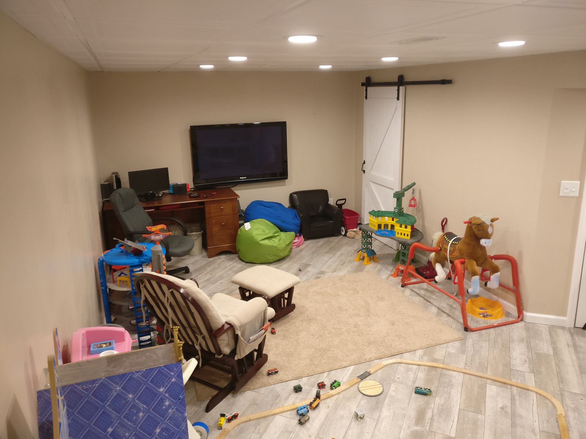

I certainly want a minimum 75" TV. I haven't decided on something like an 85" LED or 77" OLED. Here are a couple of pics (please excuse the toy mess):

The visuals help... seeing this, you almost have to put the screen on the end of the room near the opening to the stair well area....looks like it would be challenging to build a false wall on the other end with the barn closet door.
On the screens...projection means more to others than it does me. I've had one when I had a basement HT space. Not sure where they are with 4k projectors, but I think in general they're better picture quality now than they were back then. It seems like you guys will using it so the additional cost may be worth it.
