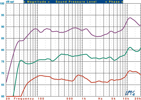

How do you read the measurements?
The software will display the measurements. You may have to tweak the software settings for the measurement display to make sense or look understandable.
That's what I mean though. What is the graph supposed to look like for it to make sense?
Here is a graph that is very typical, you should be hoping to see something like that. That has had some smoothing done, where in the 'Graph' button in the top left menu, you select one of the smoothing options. Here is a graph that has no smoothing, and it is difficult to see what is going on in the treble frequencies.
