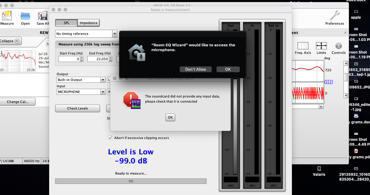

Not sure where to post this but I have the UMIK connected and the driver file loaded but I keep getting this message when checking levels. I click "don't allow" and this appears:

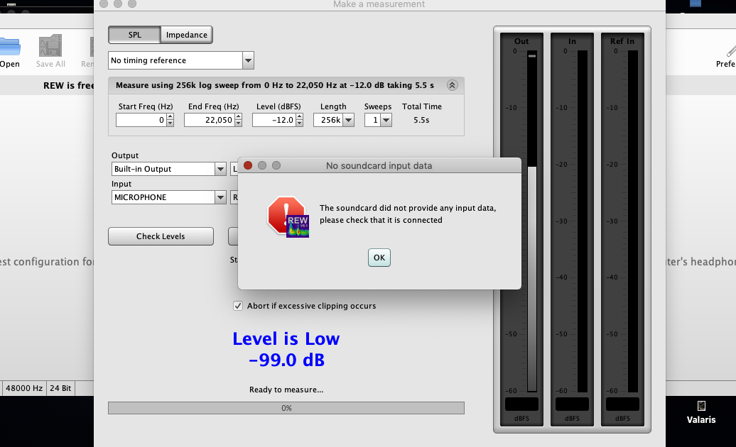

I click ok and this appears:
I don't know much about this yet but just want it to work.........

In the soundcard’s Recording Devices tab, set the UMIK as “Default Device.”

I looked for that tab but couldn't locate it. I updated the SW and it seems to be working now. However, the window for acknowledging the UMIK connection didn't come up.
