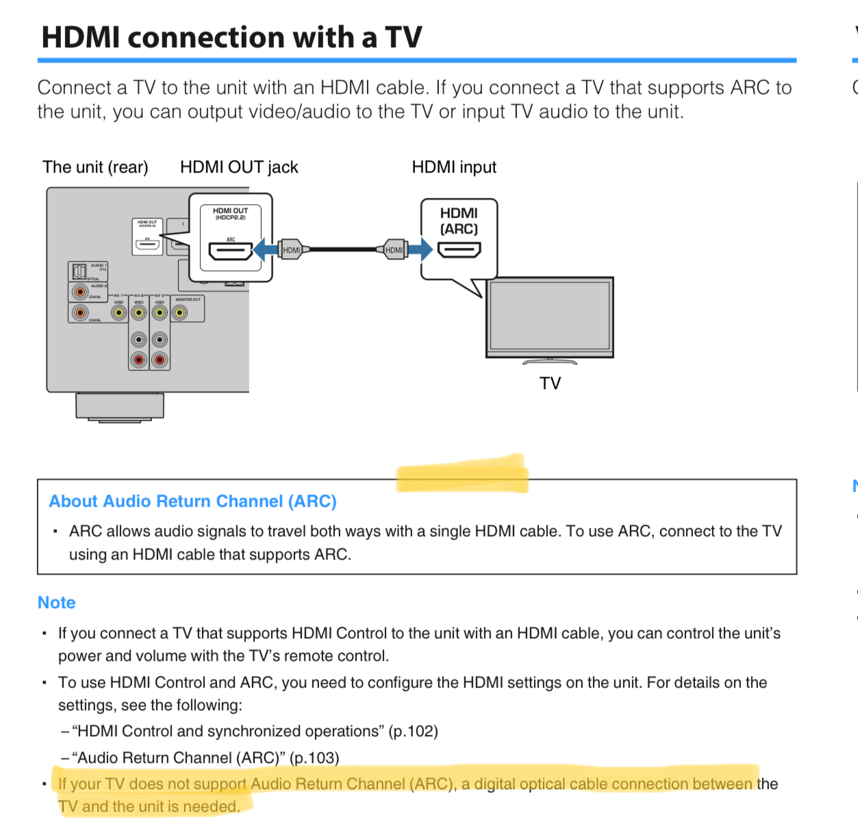

So, any suggestions? He likes Yamaha gear in particular, but the ones I looked at (RX-V385, 485, 685) all say they require ARC or an audio cable. The manual for the Pioneer VSX-834 does say an audio signal from the TV back to the receiver is not required if the signal originates from a cable box, but I'm not sure why Pioneer would be the one exception I found, and I don't want to steer him to it without confirming, first.

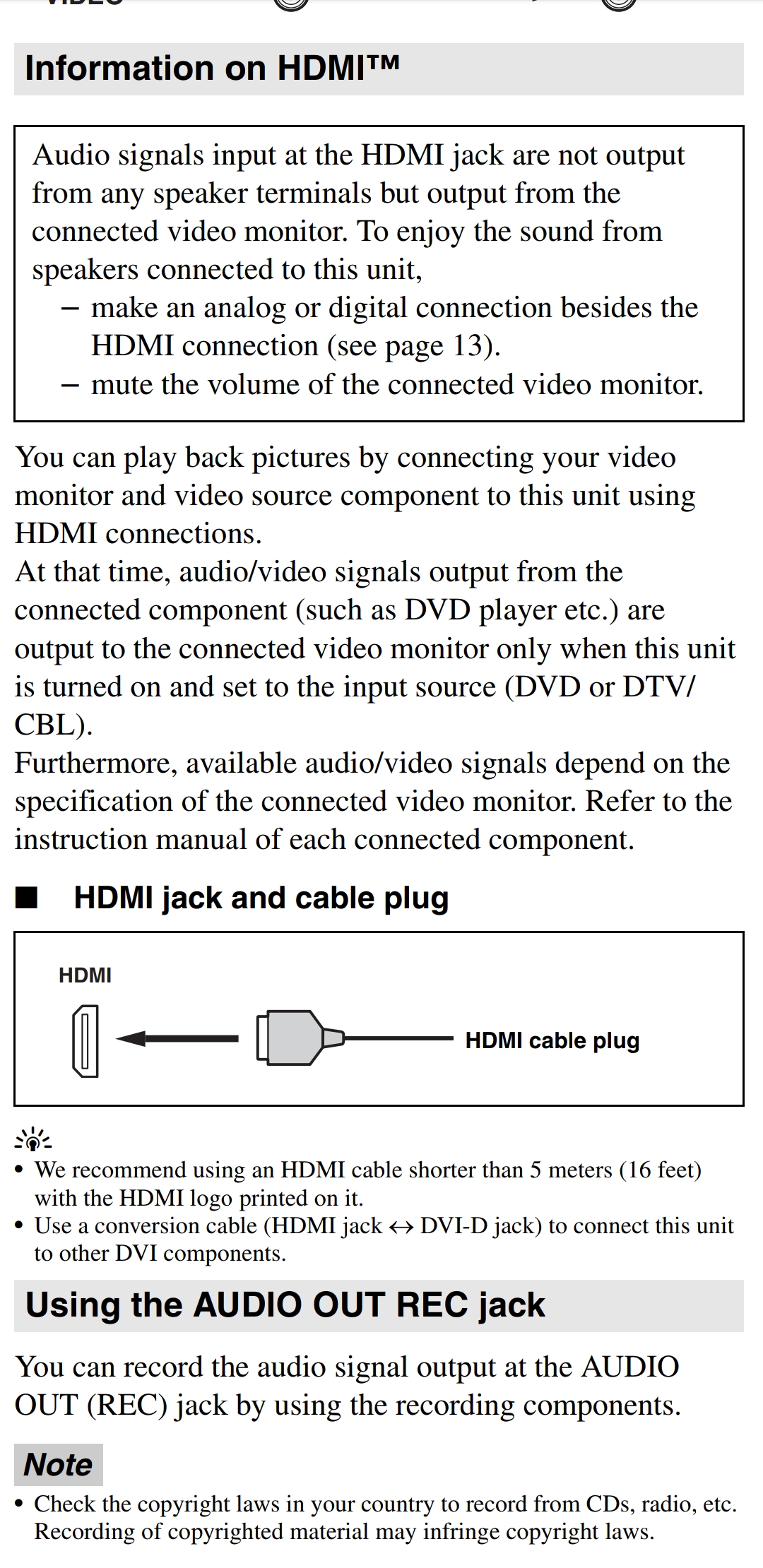

Yeah, we tried all the menu options I could find. It’s a Yamaha HTR-6230, and both the manual, and various forum posts, say it’s not possible.
My bigger concern is that even modern Yamahas have the same language in the manual. For example, the V485 manual says it needs either ARC, or an audio cable, from the TV. If he bought that unit, would he have the same issue?
Please point those forums out. An avr decodes audio from hdmi, if it was connected with optical before then you have to set the audio to hdmi. What model is the avr, without that I or other can't help much further.
Yamaha HTR-6230
It is odd, however this is what it says to do
Yup, that’s what I found.
So my question: if I recommended that the guy upgrade to something like a Yamaha RX-V385, would that solve the problem? The manual for that one does say you need ARC, or a separate cable, to send audio from the TV to the receiver (page 21), but I’m not sure if that applies if the signal originates from a cable set top box, and passes through the receiver via HDMI.
That part I understand, but if the cable box was plugged in the avr it should decode audio.
If he is looking for a new unit (sans not calling the cable company and requesting a box that has digital output) I'm assuming any newer Yamaha will work for him.
