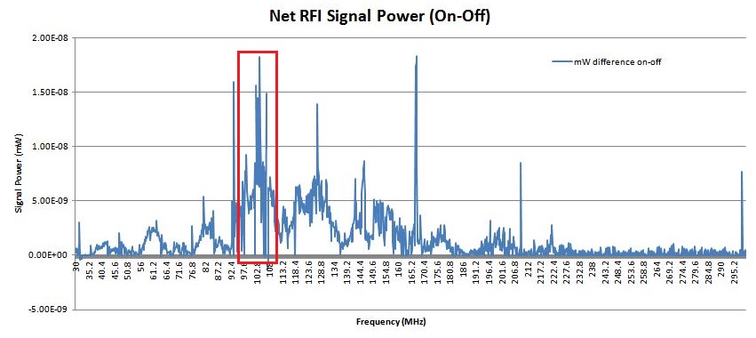

I think receiver manufacturers need to take another look. This is especially true now LED light bulbs are on the scene. If you have a number of LED bulbs in the home, analog FM listening is impossible, even on the best FM tuners. LED bulbs have to generate RF. The FCC in conjunction with light bulb manufacturers, many saying with malice aforethought, put the RF interference to be right across the FM band. Here is the spectrum.
Notice that the worst of it is in the area reserved for public broadcasting.
