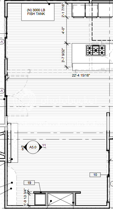

This is in my living room. The wall for tv and Mains is 15' wide. Left side wall is 15' then its open space. right side wall is about 45'. There is no back wall instead it enters kitchen and rest of living room.

Here is the room layout, Im at 5 posts, lol.

With your budget, I say do it right the first time, and I speak from some experience.
Go with three identical speakers all on the same plane, vertically arrayed.
You will have the ideal mch setup in case you ever get to concert/music blurays, sacds, dvda, etc.
That may require an acoustically transparent screen. Look at Seymour retractables, if you like looking at your speakers for music only purposes.
