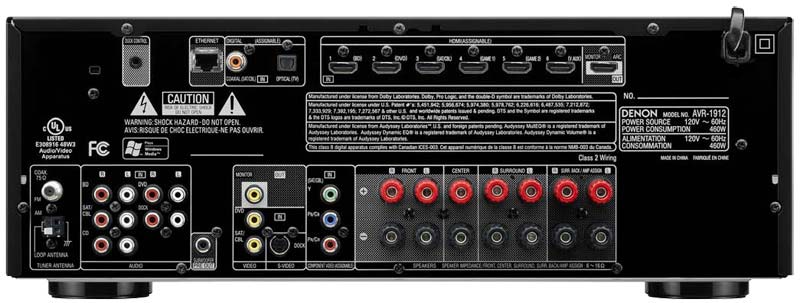

The Denon 1912 has a 7.1 configuration which will allow you to assign the Surround Back speaker outputs to a second area (think your second floor) as Zone 2. (See page 56 under Speaker Set-up in the manual.) Those speaker wires connect to the two set of terminals (black & red) on the bottom right in the photo below. You can control the volume to these separately from the mains (your remaining 5.1 speakers). See page 68 for those instructions.
