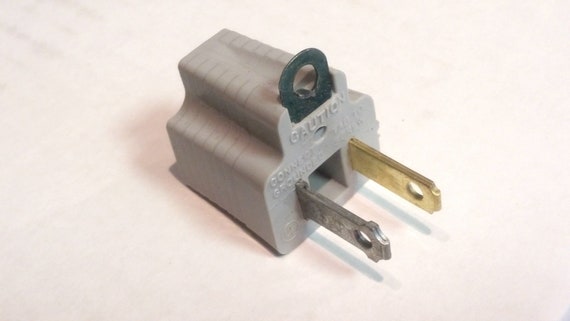

You can bet that hum is a ground loop. Do a test with a cheater plug on the sub, but don't leave it there. There has to be a difference in ground potential between what the sub is plugged into and the rest of your gear if the cheater plug is a temporary fix.
