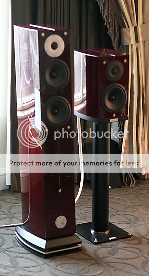

Many thanks again guys, here is a little update:
My dealer has offered to change the floor speakers for smaller, high quality ones, he claim that since the room can´t be addressed, smaller speakers should make less powered wave sounds that shouls interfere and cancel less between themselves, and so, I should get a better sound. He have sugested the Atohm GT1, that sells in a pack with the devialet, and can benefit from the SAM system thats built in the amplifier (a stuff that adapts the output wave form of the speakers so the wave that comes into the speaker throught the cable, and the wave that finally get outs, get identical.
These are (the smaller ones in the floor stand):
I know I have a real problem here with the room. My dealer has also told me, that he can install a wall picture, that is made of some anti-reflective stuff, in the wall where the bed is (the opposite from the speakers), to help improve the room a little. Do you guys thinks that with this picture, and the speakers, the sould could improve, even a little? or I am wasting money here?
Im begining to lose hope :(
