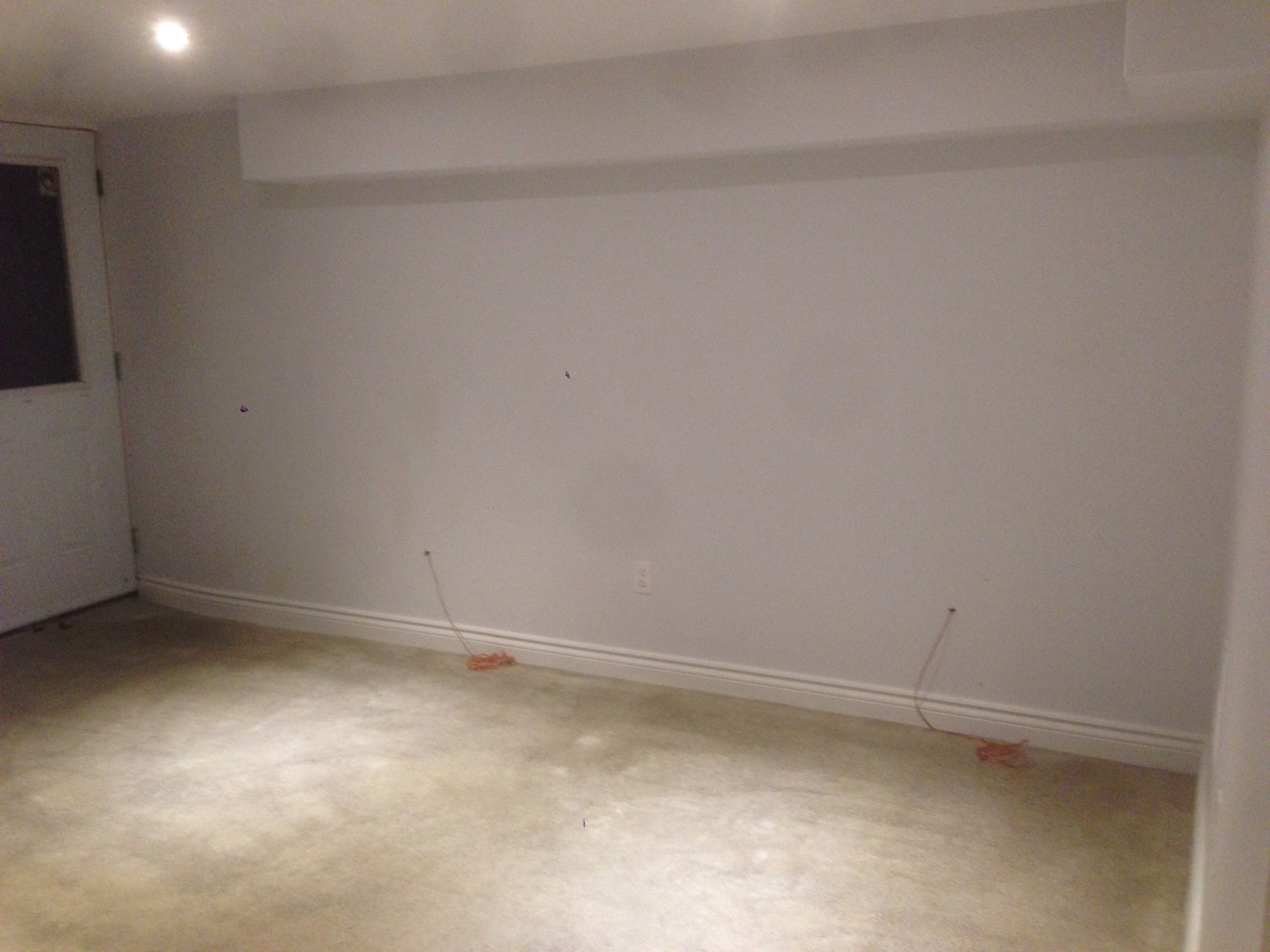

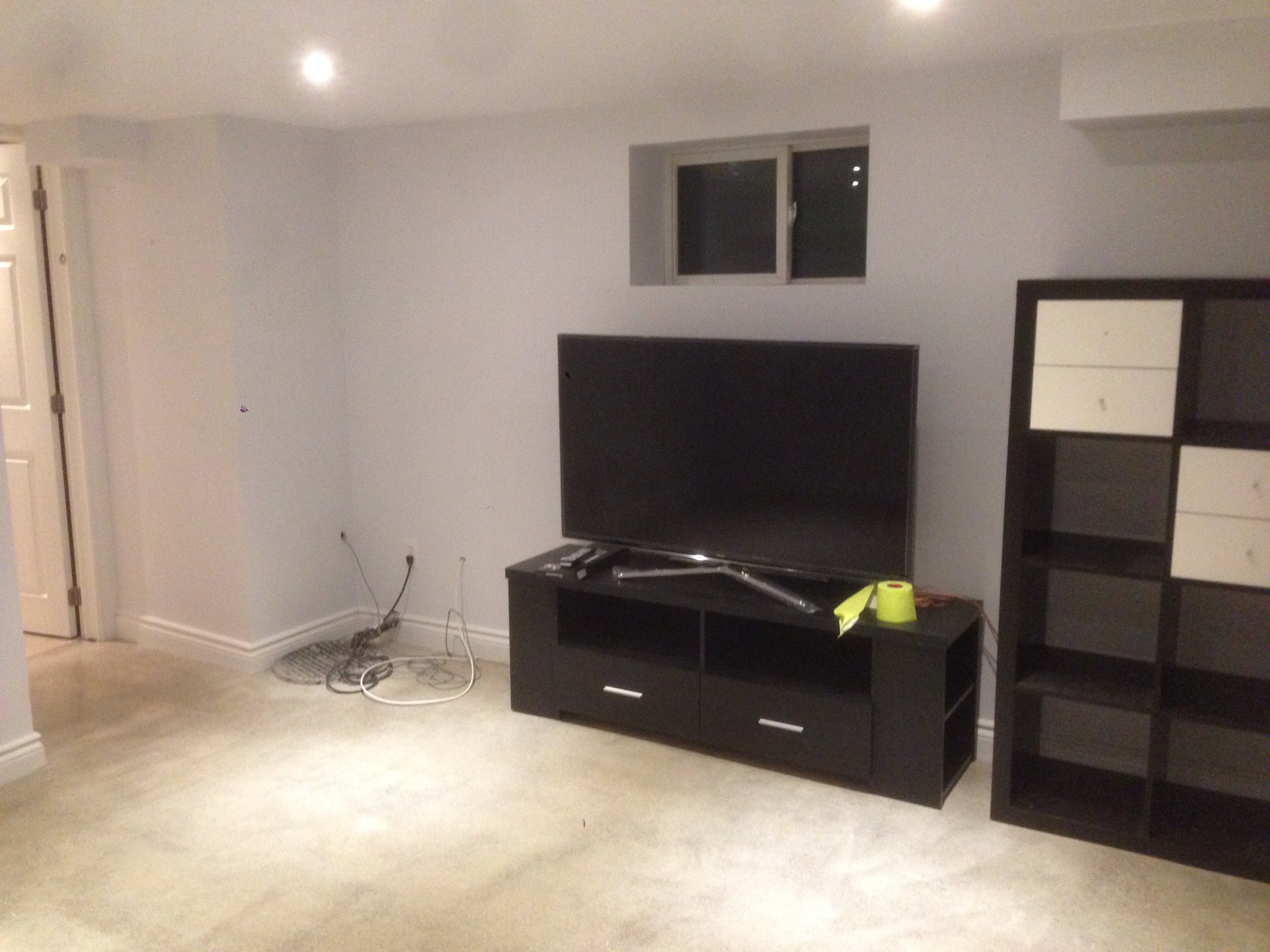

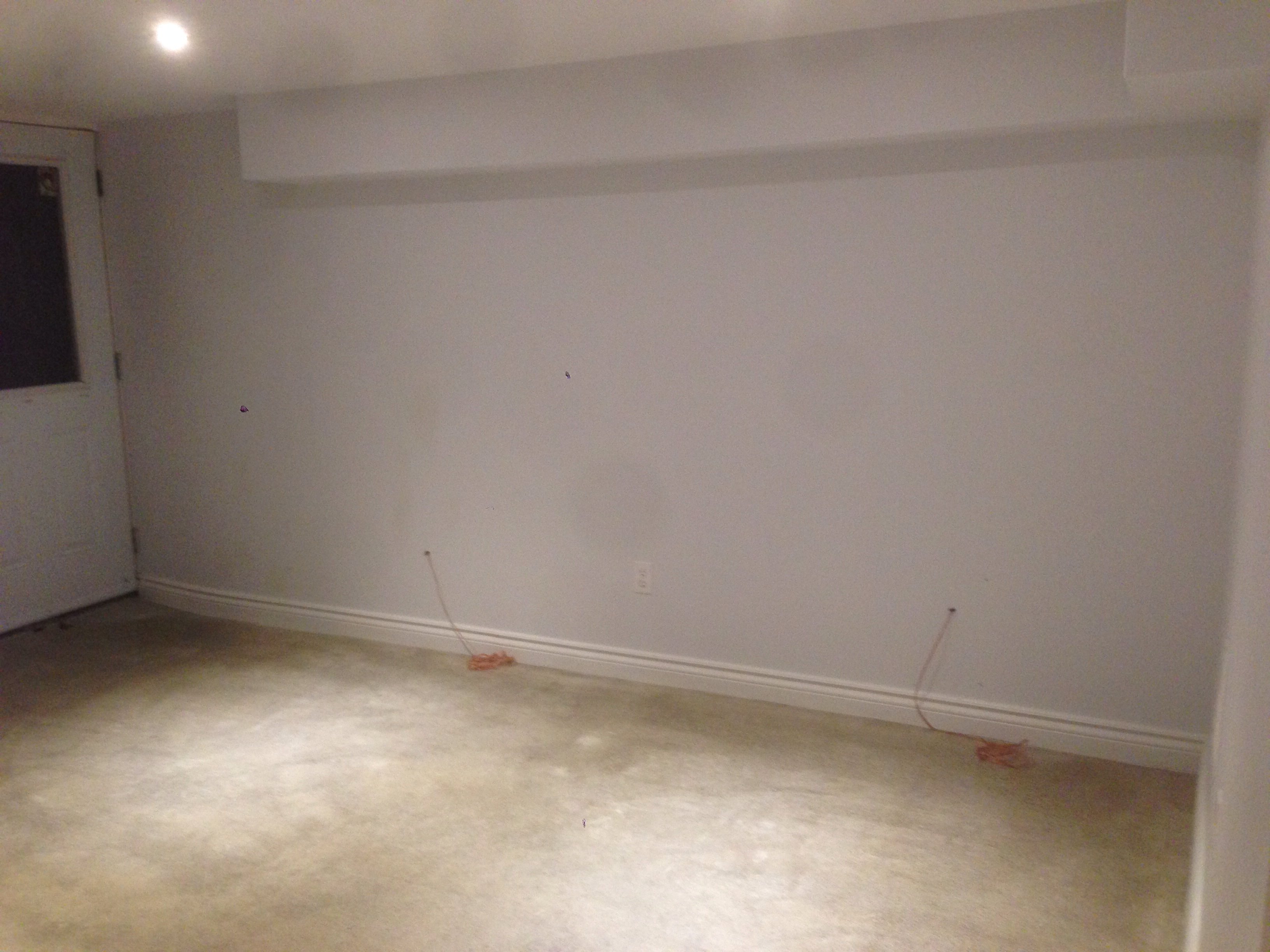

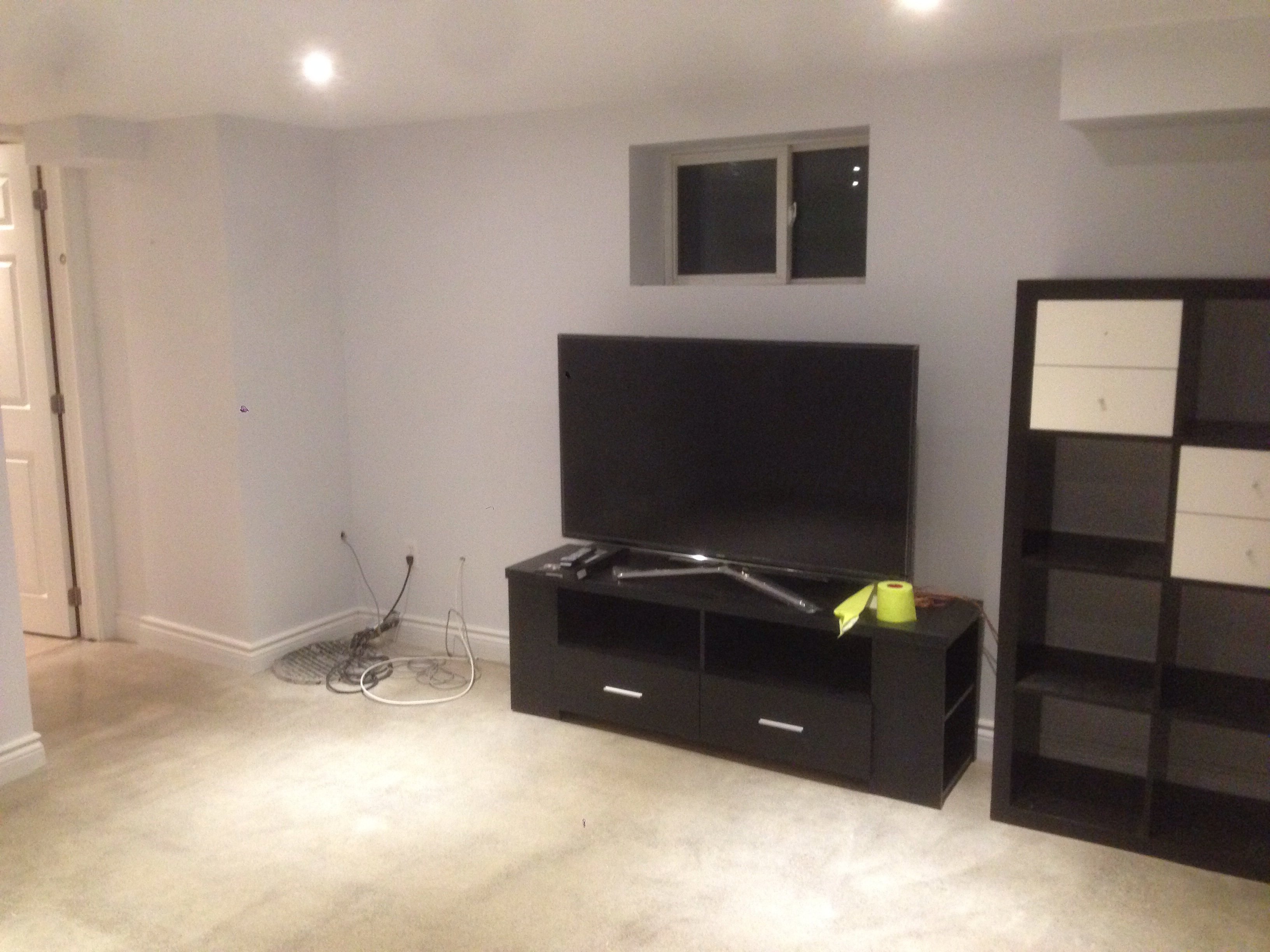

image.jpg image.jpg Hey guys
This is my first time posting. I recently bought my first home and the previous owner was a music producer. In the basement, where his "studio/office" was, still has cables hooked up for speakers, etc.
I am extremely new to audio and surround sound. I almost bought a bose surround sound system for $1000 at future shop until some friends convinced me otherwise.
Below I attached some photos of the room and the type of wiring that was left. Se recommendations, as to what speakers/subwoofer/receiver/etc. would be ideal for the space. I would prefer not to spend over $1000 if possible.
I also read the audioholics.com recommendation for 5.1home theatre for $1000. Would that system suffice?
Any help would be awesome!!
Thanks in advance!!

View attachment 14115 View attachment 14116 Hey guys
Thanks in advance!!
